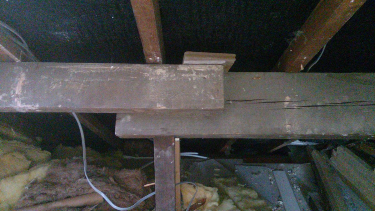

Hello! I am looking to replace a purlin in my roof because the purlin is in two lengths and is supported by a prop at the point of overlap.
I want to replace it with a single length of timber which does not need a prop underneath it.
The span between gable wall end and party wall is 4900mm. What size purlin would I need in timber/steel? Are there any span tables available?
The ground floor is 6700x4900 to give you an idea of the roof size. The other side of the roof was built the same but has been replaced with a dormer and a new structure altogether.
Can anyone offer any guidance please? (I did read through some forums but could not find the exact information I need)
A photo is attached below.
Thanks!!

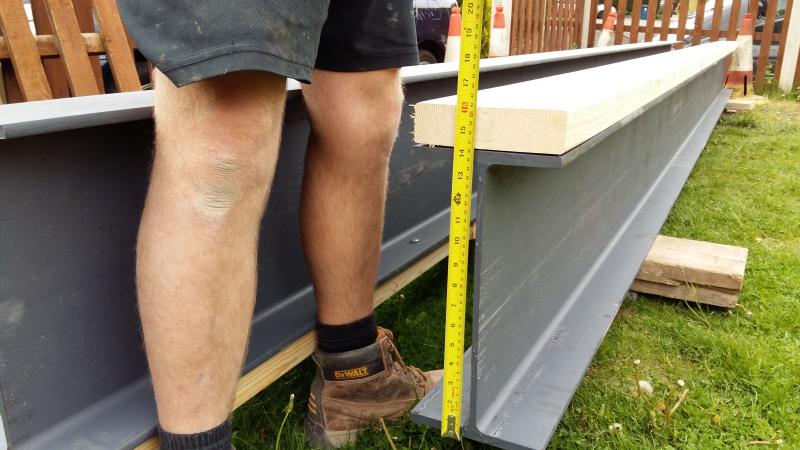

We put a pair in a roof recently that would make your eyes water.
Thanks for the replies, the roof did have a purlin each side of the pitch and I'm looking to replace one of them. Those steel beams are huge! @noseall. And the span is only abit longer than my house so perhaps mine will also be fairly deep. I have a steel beam which is 150x150 and that is supporting the new flat roof former so maybe my steel beam to act as a purlin could be of similar dimensions, I will have to ask a structural engineer.

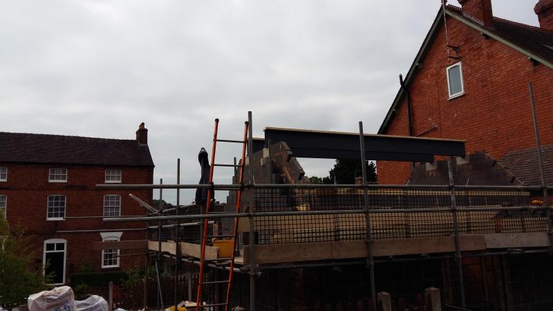

I think there was a cock-up. The SE assumed the span was 8m.
@ Nose - you showed us those purlins a little while ago, and their bloated size drew much attention.
If the SE made such a simple cock-up, did she(?) offer to recompense the client for the additional (unnecessary) expense!?
I don't think it has ever been brought to her attention. The architect (who allocated this SE) laughed it off. So, I don't know whether he made the mistake or her (the SE). Either way, he's not very forthcoming.
