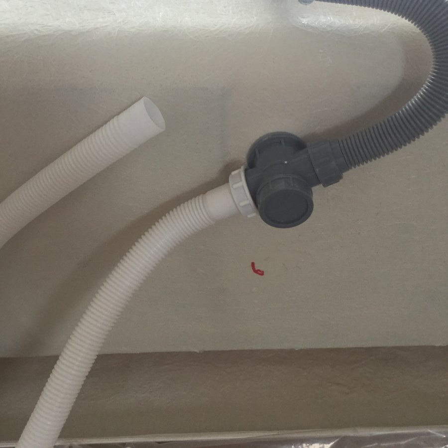

I need help Anyone come across this
15 Apr 2016
4

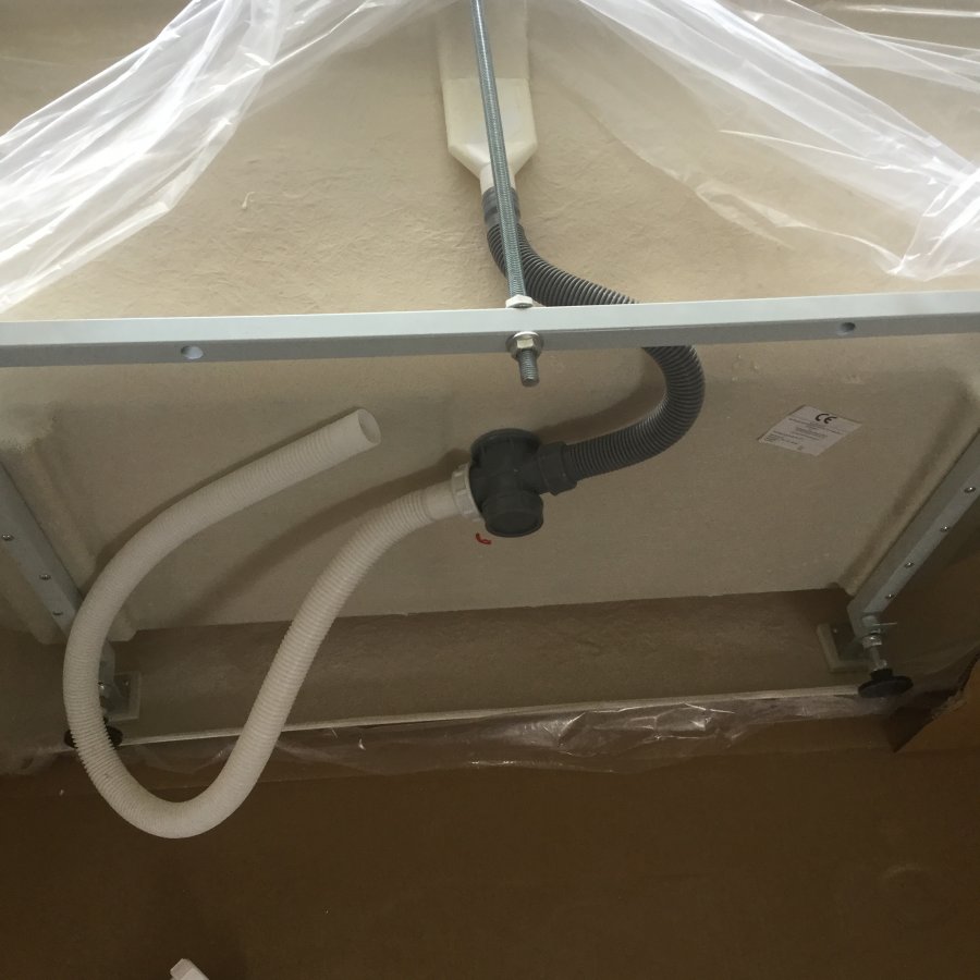

Hi never seen anything like this, it came fitted to bath as a combined waste and over flow, does it act as a trap? Secondly what or where do you attach the waste flexi pipe as its too small and doesn't seem to fit anything
Hazet, Dan I've blocked the flexi hose off and tried to fit standard trap to bottom and it won't fit either, sounds like standard set up and bodge something on to built in overflow
Looks a bit like those weird things Ikea supply with their sink units. Apart from the overflow, which was unique to the sink, I binned every thing and went the McAlpine route.
Just bought new waste and overflow and the friggin overflow pipe is to small to marry up, just slides freely into existing and to small to bodge or stretch over Remain in European Union when importing ****e like this
