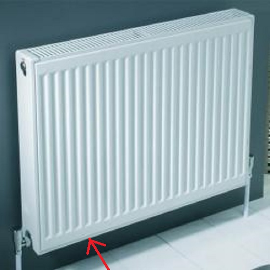

Hi all,
I've just noticed an extremely slow drip coming from the kitchen radiator. It's not leaking from any of the valves or bleed valves or anything but down the rear of the radiator, part way along like I've arrowed...
(stock photo BTW, not my rad)
This just happens to be exactly in line with where the brackets are welded to the back of the rad. Is this a common fault? Is there some way I can repair this leak with an additive or something? It was probably dripping once an hour it is that slow. I just added some pressure at the filling loop and now it drips maybe once every 20 mins!

It's Donald Ducked, it'll only get worse!
Probably around £40 to buy a direct replacement, I wouldn't bother trying to claim anything
As above, if it's rotted through you need to make sure air isn't getting into your system and you have sufficient corrosion inhibitor in there. If you try to make a warranty claim, the first thing they'll want to do is test the water quality and if it's not right your claim will be thrown out and they'll most likely charge you handsomely for the testing
IT'S 9 YEARS OLD!............................... Just replace it.

Amazing that anyone expects it to still be under warranty after 9 years.
But in any case its likely to be a problem with the water.
I wonder if the OP knows what make of inhibitor has been use and if he has a service record showing it being topped up every 2-3 years?
As said, a water fault can result if further rads developing pinhole leaks if not immediately sorted out.

The radiator comes with a guarantee.
But that only applies if it has been fitted to a system properly dosed with inhibitor, which is kept regularly topped up and which has no oxygenation faults.
Lots of rads and now boilers come with 10 year warranties but in your case the 10 year warranty is for manufacturing defects and after 9 years they would not honour it if it leaked after a week yes they would give you a free replacement which you would have to pay to have swapped, just buy a replacement, if you can get like for like then it should be a straight swap but if not wont take a pro very long to swap the brackets over
