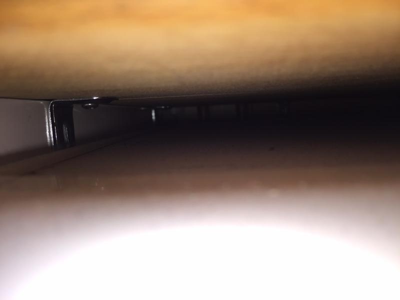

I thought i'd update this. I've now had the report back and it looks like the worktop wasn't installed correctly. You can see the details below.
Is it worth retrospectively getting the brackets changed so they are the right way round? To the untrained eye it looks like the rest of the worktop is ok and if it was going to split it would have done by now as it was installed June 2013. So perhaps just leave it be and fill in the splits with wood filler.

Brackets fitting the worktop to the units have been put on the wrong way round and no gaps have been allowed for the worktop to move
Action Taken
Found no extractor unit fitted. Brackets holding the worktop to the units put on the wrong way and no expansion gap against the wall. This is not a manufacture fault . Customer fitting issue.
Are the brackets installed incorrectly?
You said he didn't look, and the picture you provided is inconclusive.
He has probably assumed, and may be right, but be sure.
If it is so, then yes just re-fix the brackets correctly.

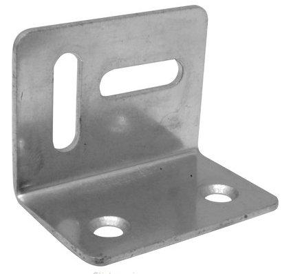

Difficult to see, I agree, but the brackets appear to be wrong to my mind with only one vertical slot:
But the plates should look like this:
The slots should be against the material and only the front to rear slot should have a srew in it on the worktop side of the joint
