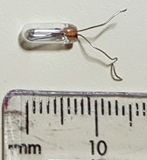

I wanted a louder doorbell and the one I got can now be heard anywhere in the house. Its 24V which needed a new transformer and I found the bell rang continuously until I removed the bulb from the illuminated doorbell button as it was being overpowered by the higher voltage.
The problem now is that visitors aren't seeing the doorbell and its even harder to hear them knocking. Is it possible to get an illuminated button that will fit straight into the 24V circuit? Or do I need an illumimated button on a lower voltage circuit that triggers some sort of switch and any suggestions as to what that switch should be (from Screwfix if poss)? Thanks

Now I've taken the lamp out all the button is doing is complete the circuit. Before that the lamp was in parallel drawing a small current so that it stayed lit. 24V was enough to overpower it and make the bell ring constantly although rather pathetically.
Just for referance, the lamp was more likely in series :)
If you could change the cable to 3 core, you may be able to solder a small lamp in the bell button, wired across the transormer output
Lamp was in parallel with the push :)
Try an LED (2 volt, 20 mA forward current, any bog standard red led should do) with about 1 kΩ resistor in series (assuming a DC supply). That should drop the voltage across the bell to about 12 volts, and according to the data sheet they ring on about 18 volts upwards.

I'm not sure my soldering skills are up to fitting an LED, it's pretty tiny. So first off I've decided to try fitting a relay switch. If that works the door press will be illuminated again on a 12V circuit which and that'll actuate the relay to close a 24V circuit through the bell. Fingers crossed.

Those bells are very low current and consume about 20-30 mA which is what will be passed by the LED. You could actually (probably, ignoring motor theory) use the bell as the series resistor for the LED on 24 volts (and the bell would ring). Current is the same through a series circuit, so you need to drop the voltage below the bell trigger level.

This bulb I took out is tiny & I didn't find a replacement; all the illuminated door pushes I found are 12V max. I've ordered the relay now but if that doesn't work I'll look harder at changing the bulb.
