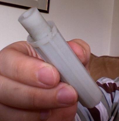

I've had a good look inside the machine by taking the top off and nothing appears to have become disconnected. Nothing appears to have burned out.
I did find a plastic object loose inside the machine. It looks like a short candle. I've attached a photo. I can't see any other objects like it inside.
