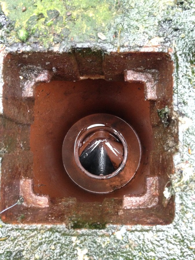

So I have a "chamber" in my drive where I would like to extend to, isn't that nearly always the case.
upload_2017-1-22_13-6-9-png.814861
I had always assumed it was a rodding point for the foul water, the soil stack is internal and runs to the left of the little window you can see above

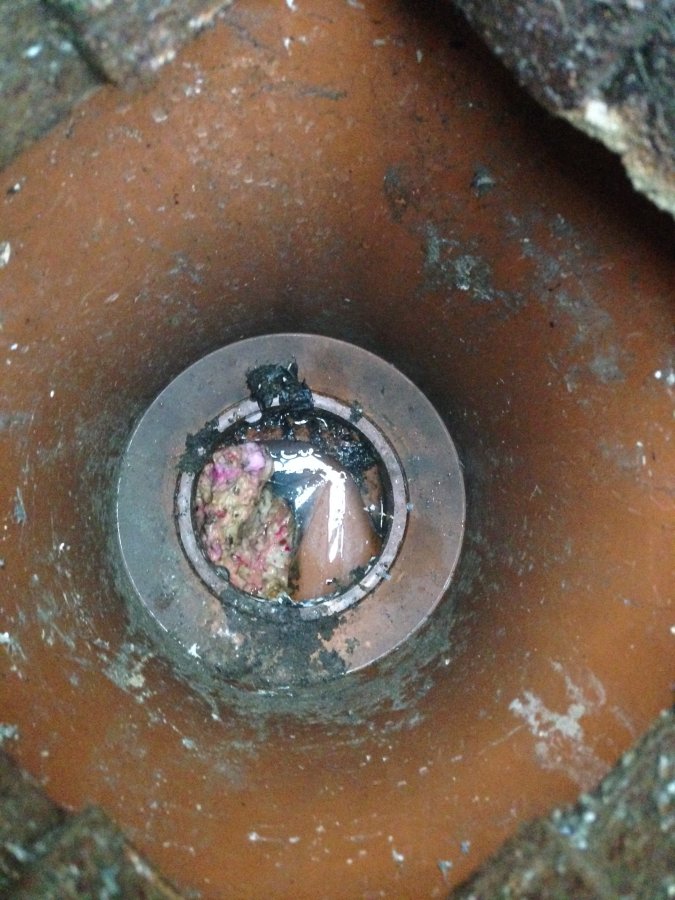

Popped the cover off the other day and saw this
upload_2017-1-22_13-4-26-png.814860
Not quite what I was expecting to be honest . was expecting to see a gully of some sort I guess.
Flushed the loo, nothing happened . so I have a couple of questions
Is it one of these
upload_2017-1-22_13-42-30-png.814875
If not , what is it, whats it for and can I move it to somewhere I don't want to build :D
Am I likely to get the answer to any of these questions without resorting to digging the drive up
thanks for any assistance offered
JS

Thanks, so its effectively a plug hole, even though its 3/4 the way up a sloped drive with a concrete cover and no means of surface water draining to it ?
Are you sure that middle bit at the bottom isn't a second lid?
I've seen some chambers like that with a smaller lid covering a Y junction.
Hmmmm. Could be. I can't actually reach it. Feels solid under a 'prod'
Try some pliers on the smaller circle that's just below the water. Give it a tug and a wiggle ;)

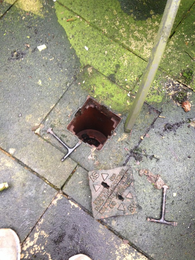

Look on the back of the cover - it might give a name and or serial number.
If you dry out the water at the base maybe more will be revealed?

If your house was older i would say it was a Buchan trap? It could be an interceptor of some sort due to a back drop or sudden change in the height if the drain run.

My money's on that is a mini chamber on the run from your property to the main sewer, to allow access to your drain. Once that lateral from your property joins the main sewer, access to that run would be available from the chambers on the neighbouring properties either side.
Look familiar?
My PM job, investigating water in a cellar and they have the same inspection chamber, minus the extra lid/cap.
Sorry about the pile of turds ;)
Interior IC's should have sealed covers if they run to a mains connection.
That is what I was expecting to see. But it's not. There is no visible flow when I flush, not even a ripple
Reached in with pliers to grab the 'pipe'in the middle of the puddle. But it's not shifting
Wondering if the only way I am going to find out is to dig the drive up and follow the pipework
