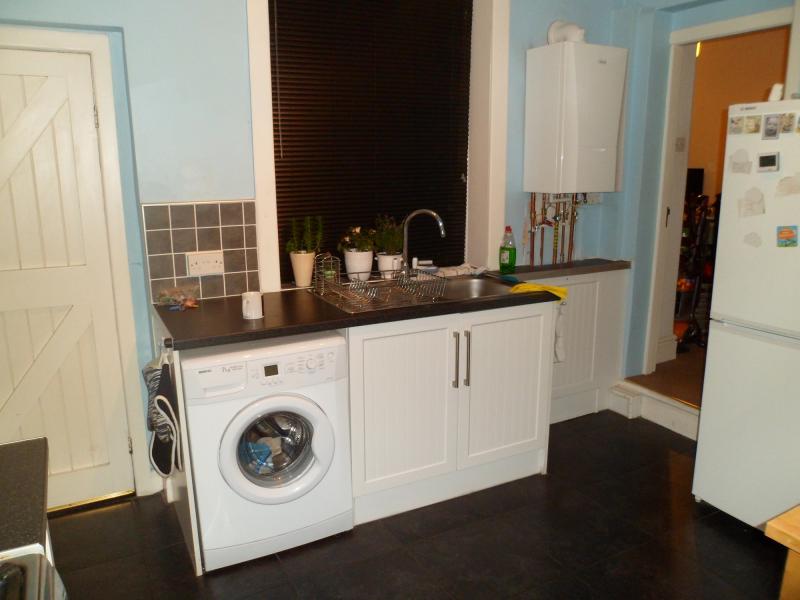

Just wondering if anyone could please advise on installing a dishwasher in a kitchen that hasn't been designed with one in mind?
We have a washing machine plumbed in next to the kitchen sink. The kitchen sink is housed in a double unit approx 70cm tall excluding baseboard, 50cm deep (panel at the back) and approx 50cm wide from one side to where it meets the sink.
Under the kitchen sink is the waste which exits straight out of the wall under the window and goes down to a gully next to the (outside) cellar door, water connections come to the sink from the right hand side from the cellar.
We believe a slimline dishwasher could probably fit under the draining board of the sink, but I've read that this would be difficult to install? and we really would be better off with a full size model as it'll get full too quick etc. but can anyone advise would fitting a full size dishwasher be possible with this kitchen arrangement please?

Welllll this is where your carpentry skills / luck / imagination come into 'play.....you'll have to lose the left hand carcass door, middle and lower shelf and the plinth.....maybe the back too. I presume you don't want to take the base unit out for modification!
Not really a huge problem for a joiner, but naturally enough you would need a vertical filler strip 50mm wide to cover the remaining gap.
By being savage with the carcass parts that you definitely don't need, its usually easy enough to saw to an edge. You may be surprised how helpful a stanley knife and a straight edge can be.....!

Yup, as burnerman say, you'll need to get creative with the shelves and back. Leaving the left hand side vertical where it is you will need to get a piece of melamine to vertically panel what will be the left side of the single cabinet you will be left with under the sink bowl to stiffen and enclose that section. In effect leaving you with what you have at the washing machine at the moment.

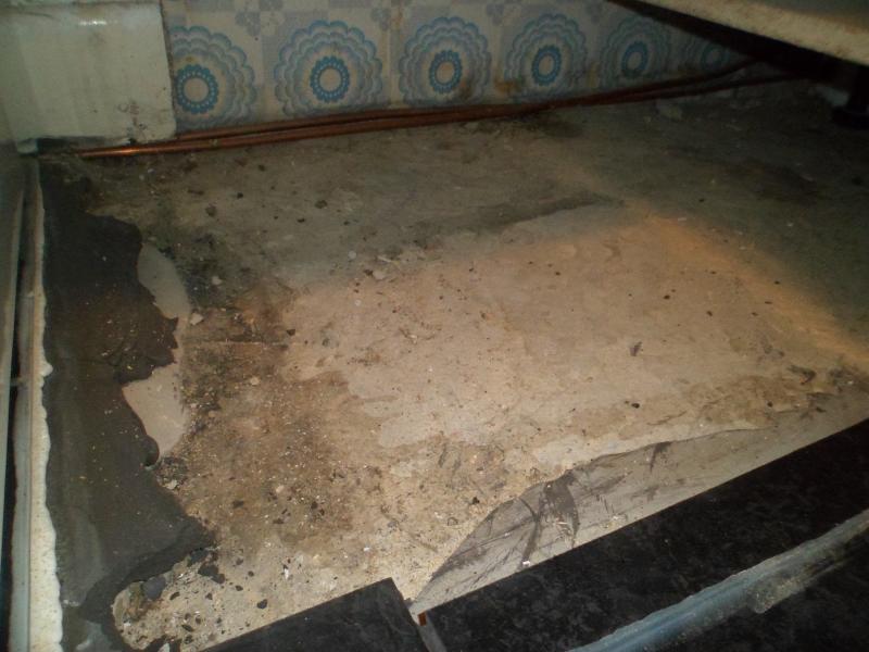

It is me again, I've done a bit of careful hacking and I'm getting there now; the unit under the draining board is pretty much removed.
My main issue now is it appears the kitchen was never fully tiled; it's only been done to just behind the unit base boards so I'm left with a large unfinished, uneven area where I need my slimline dishwasher to go - oh no!
This area is roughly 1/2" to 3/4" in depth from the top of the edges of the existing tiles.
The original floor is probably york stone, it looks as though they have probably put some kind of screed or concrete over this, tile adhesive and then tiles.
The tiles are porcelain, I was told this was used as it is impervious to damp, so it should keep the kitchen warmer and dryer.
Anyway what can I do in this area please to make it level for the dishwasher? How should I tackle this.. what tools and materials would be required?

I think the easiest way would be to do exactly what they did.
Some leveling compound, then adhesive and get some tiles that are matched or as close as to the ones already down and set to the existing floor level?
Just make sure you protect the copper pipes running at the back from the compound/adhesive

I have a couple of full tiles and some part tiles in the cellar left over from the previous owner but I'd need to buy the self-levelling compound, tile adhesive and grout..
Would it be possible to just put down some kind of concrete as a quicker and cheaper solution, or is there a reason why I shouldn't do this?
Many thanks.
Typical pants ideal boiler installation there. Condensate drain runs uphill :rolleyes:
Anyway. Batten out the area and pour some self levelling latex screed in there. Remove battens and fit washer.
No point bodging these things. Especially now you've got this far. So protecting those pipes would be wise. Looks very tight though.
