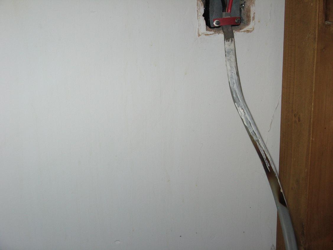

The old cable looks a bit old and tired
Unless it's physically damaged or falling apart, a bit of Cillit Bang and a wet cloth will have it looking as good as new in 10 seconds.

Here's a pic of the cable. I'll leave you to decide which bit concerned me :)
Any further thoughts or advice before I call around for an electrician tomorrow?

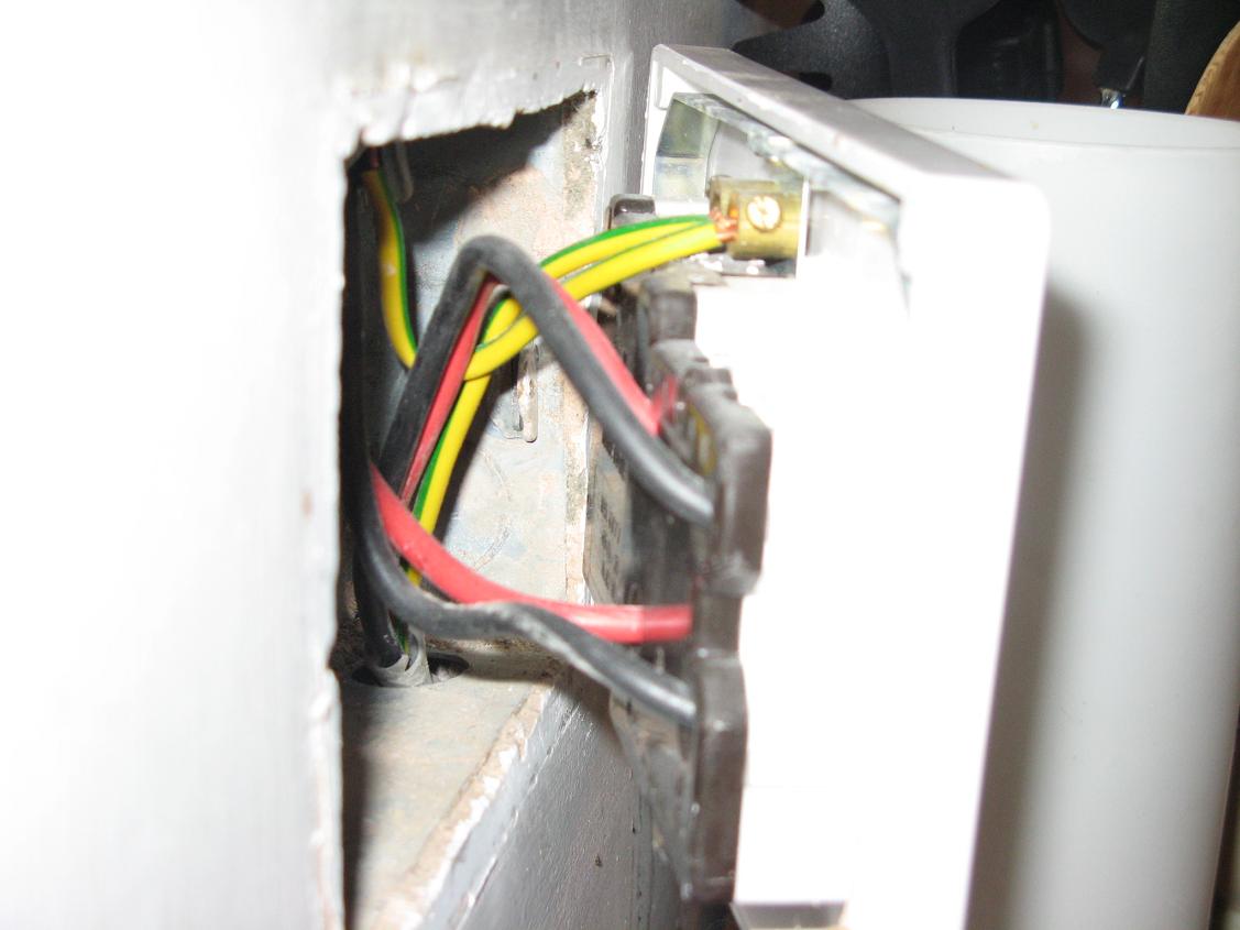

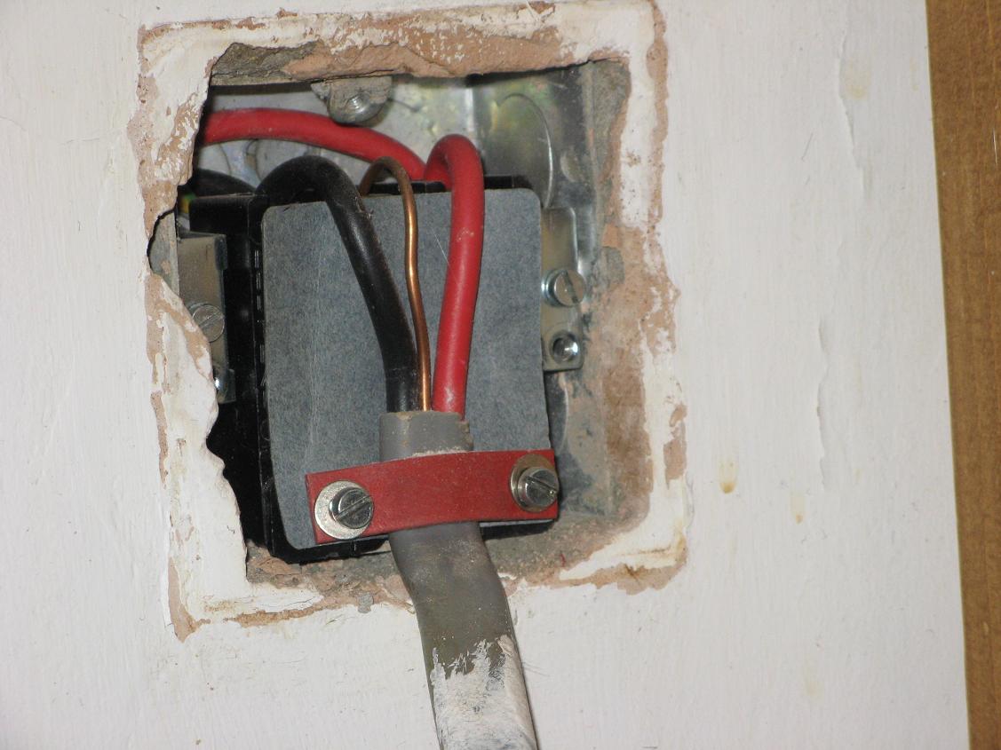

Also, RE the wiring in the walls (CU -> Isolator -> CCU), how can I tell what spec the wiring is when it is in the walls? How does an electrician do it? With some kind of equipment or just by eye-balling the ends at the socket, etc?

Well, as luck would have it I do have some photos of the internals of the isolator and the cooker connector unit. So would anyone mind taking an eyeball and seeing if they are clear enough to see what's there? Or at least to judge whether it is the same going in as coming out (which it seems to be to my untrained eye). Pics below.
Quite hard to tell from a photo. It's possibly 6mm². There is a table of the dimensions of typical T&E cable sizes in the much ignored WIKI.
