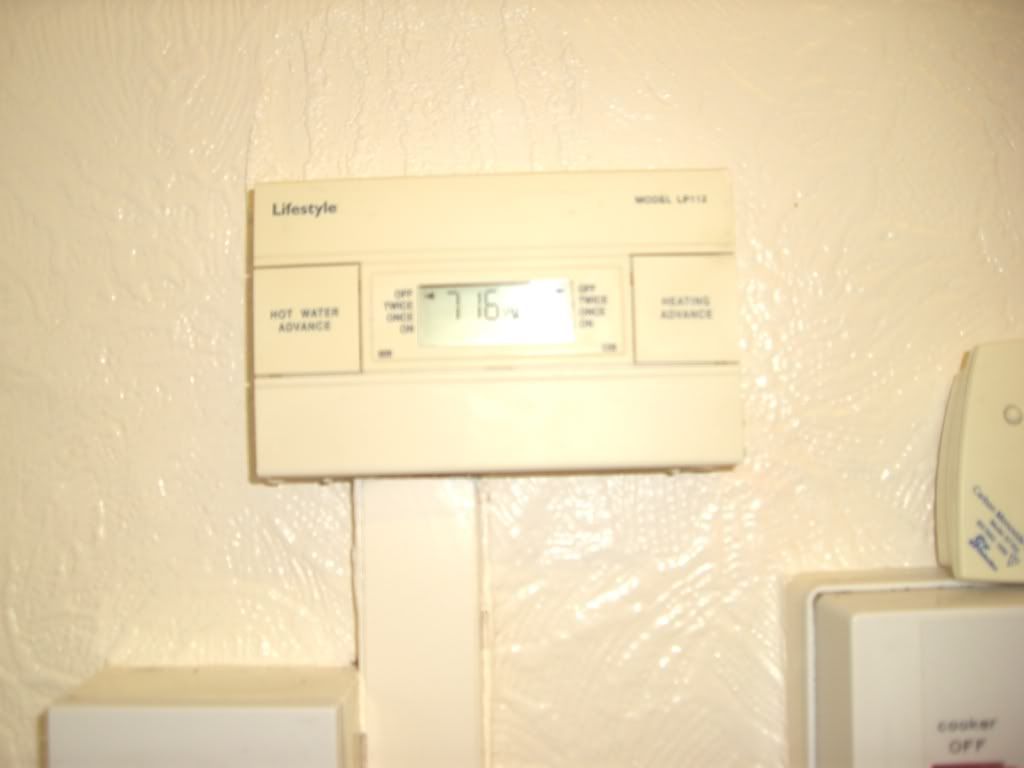

Insurance company, heating would not turn on. Won't fix it!
Sorry for the late reply.
See images of programmer & wiring to it.

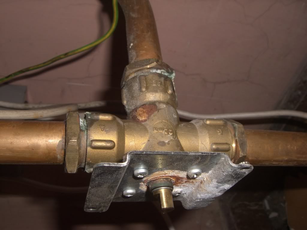

The valve can be turned by hand with some ease, no apparent leaks.
Be back in a few hours. Let me know what you think I should do.
Thanks.
unlucky-you have an icos. (your 3port valve is the least of your worries)
Carp installer. Controls should have been sorted when the boiler was installed (but anyone fitting Ideal doesn't care about customers).
The hot water off wire is missing from the programmer, AFAIK it is required on the Duoval setup. Does the boiler have a permanent live? Without tracing all the wiring it's impossible off the images..presumerably there are further connections elsewhere.
I'd ripout the Sunvic and use a couple of Honeywell 2 ports with the Honey wiring center.

I see no more wiring anywhere. If you look at the programmer underneath it there is a on/off switch. This powers the bolier & programmer. Didn’t think to put that in the image. :rolleyes:

Geoff, I think the second off contact is not required because the relay gives the "off" signal to the powered off valve. Of course it would have been easier to lose the relay and put in an extra wire. ( But he only had four core and earth! )
I hope he is going to replace the leaked valve body!
