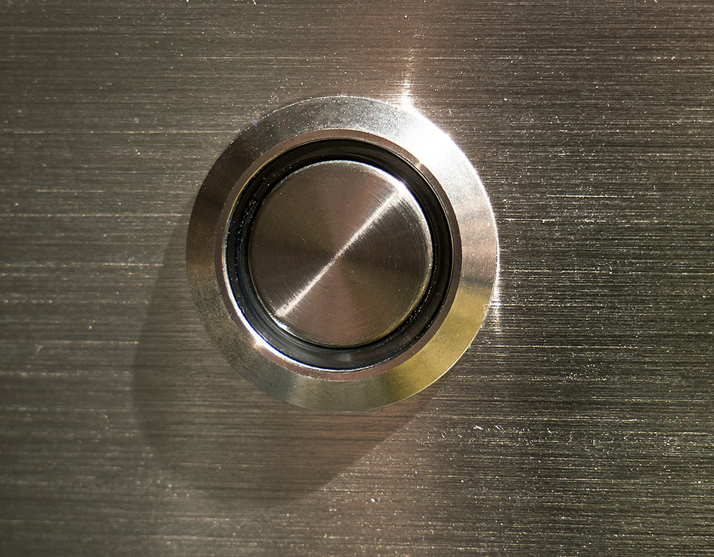

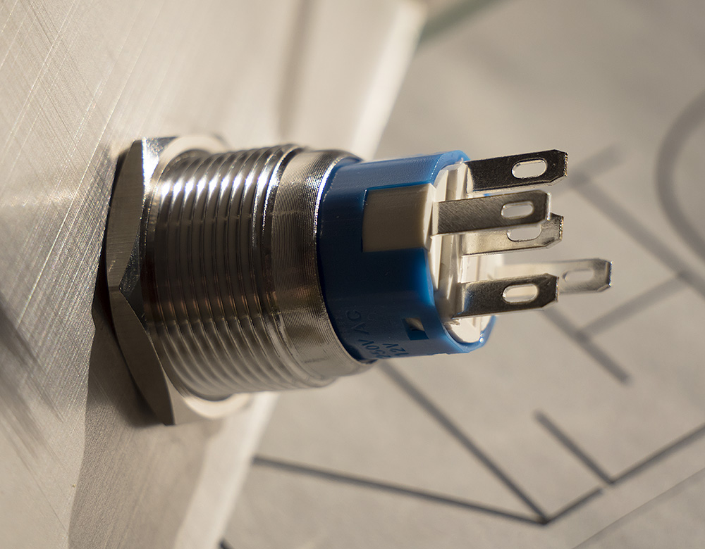

I have attached a couple of photos that show the sort of illuminated pushbutton I am talking about. The circular LED-powered light is white. I'm not sure if there is any way to dismantle it and replace a blown LED, so I am not planning to connect any power source until I am convinced it is safe. Replacing the entire pushbutton would be quite expensive.
So far, I have failed to establish the make and model of pushbutton, which makes it difficult to be certain about the internal components. The supplier's website claimed it was a Bulgin part but when I sent my photos to Bulgin for confirmation they told me it was not one of theirs.

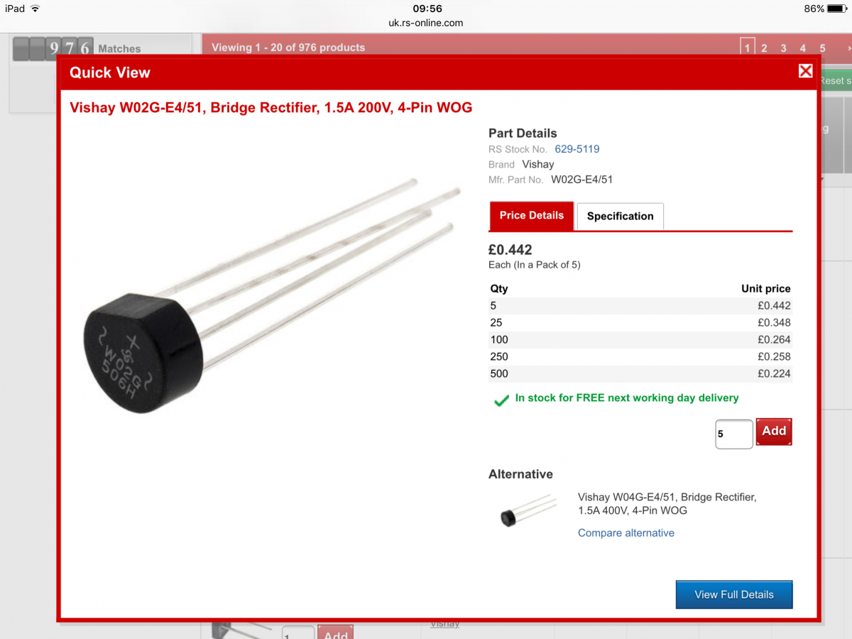

Solder a bridge rectifier on to the button led light terminals .. I use these on AC door entry systems when a DC device is required .

I like sparkymarka's suggestion of a bridge rectifier. That's a far cheaper and simpler solution than the dedicated LED power supply I mentioned in my last post.

You're lucky that it has 4 terminals, so you can add components to affect the LED but not the switch.
I'd add a bridge rectifier and/or a 7812 12V voltage regulator.
The switch has 5 pins, I am presuming the middle 3 pins in a row are c/o contacts (i.e. NC, C, NO) and the two other pins are thus LED feed, If the LED is rated to run on 12v DC, it would mean it has built in current limit, so one can apply 12 directly to it, with correct polarity if it is DC, if you want to run it off ac, you can use a single diode in series like the 1N4001 or a small bridge rectifier. No big deal here. Even if you were to apply 8v ac directly, LED would sustain no damage at this low voltage, however since you mentioned your transformer can reach as high as 16v when not on full load, but for an 8v transformer to reach 16v off load appears that its output is already rectified and smoothed by a smoothing electrolytic capacitor, so it may well be outputting a DC voltage, it is for you to confirm if your transformer really has a dc output or is it simply a true ac output. ( If you have a multimeter you can check this, or if you can open it up and see if can see any components inside like a few diodes forming a bridge rectifier and a smoothing capacitor.
