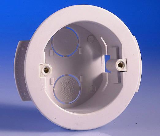

Is there such a thing as an extra deep celing rose?
How many cables are being joined at that ceiling rose ?
By cable I mean 2 ( or 3 ) wires plus earth wire in a outer sheath.
Word of caution. If the lid is compressing wires when it is screwed in place you might be damaging the insulation on the wires. This could cause an immediate fault or one that happens later.
There is so much wiring crammed into mine I had trouble screwing the "lid" back on!
Which could suggest you have too much grey cable on show - or you are overloading the ceiling rose. I can normally fit five T&E cables comfortably in the standard ceiling rose - how many have you got in this one.
What I need (but cannot find) is a deeper celing rose. Anyone know of such a thing?
The issue is less about depth and more about terminal availability.
Which looks like a standard ceiling rose.
Wow that was quick! It's three wires, connected using a terminal block. It's really tight for space in there.

In which case you should have loads of space - just ensure that the grey insulation doesn't protrude into the ceiling rose. As for terminal block - does the inside of the plastic ceiling rose look like this

In which case if you have three cables then you have the live/neutral/cpc loop (2 cables) and the switch wire - there should be no issues about not having enough space in the ceiling rose.

Use an Ashley rose pattress and a Klik rose, that way all the wiring is tucked behind the plate in the pattress and the light is attached on the plug side.
Come on we are only dealing with three cables into this ceiling rose - unless its an unusual cable size - there is more than adequate space to fit inside a standard ceiling rose.
