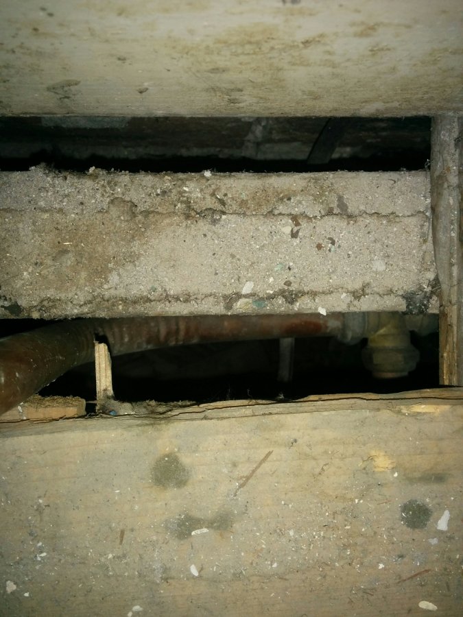

Hello,
Looking for some advice/clarification on a copper pipe sticking out floorboards (22mm or 28mm cant remember) .
Moved into house couple of year ago and had a gas fire/back boiler removed and central heating put in with a new boiler put up in a cupboard up stairs.
Middle of decorating living room, so I stripped out some boxed off sections in the alcoves next to fireplace that have been housing copper pipes leading up through the house to loft where old tanks had been.
I have removed the copper pipes, but left with this pipe sticking out of floor. My initial thoughts that it must be a water pipe and was attached to some sort of water pump for the backboiler, (no idea how back boilers work to be honest).
Not sure why the guys never capped it off below in the first place, but does this cap look like something you would use on a Gas pipe?

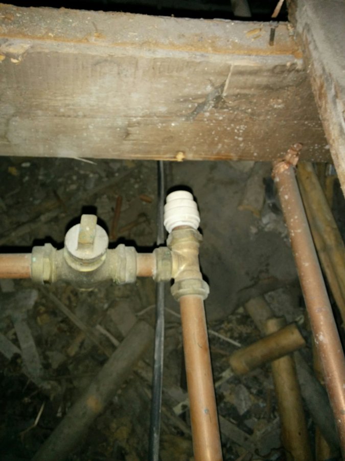

I lifted up the floor boards since taking the pics and the pipe on other side of T joint(?) from what i can make out looks smaller in diameter goes through brick work leading to kitchen. Other pipe goes way back down full length of room, so definitive answer from that.
If I call someone out would they cap it off further down the pipe or at the T joint? Just so I know want work is involved, if need a gas safety guy out and not getting charged for 'having to use a left handed wrench to access it.'

Sorry the only way is to trace the pipes back to where the come from. Copper fittings are the same for gas and water. Hopefully it is water as putting compression joints under the floor as in your second picture is a no-no for gas.
Might be better to come at it the other way and try to trace your gas supply from the meter through the house.

Checking it from the gas meter end be a bit difficult as it sits in a small cupboard which is located within a small cupboard under the stairs, so tight space and same location as where the main electricity feed comes into the house and the flooring on floorboards are like super glue.
I will rip up couple more floor boards up and see if I can squeeze underneath and follow the pipe back the way. mask and headlamp will need to be looked out.

The problem is a gas man can turn off the gas before undoing the cap and if it is empty the smell will be a big clue! Trouble is if it is full of water things can get messy, so tracing is the best way to go. If it is gas really compression fittings should only be used in accessible areas. Strictly it should be soldered joints only underfloor so it would be best to strip back to a soldered joint. If it turns out the supply has been disconnected elsewhere and the cap is just to stop the old pipe smelling then compression joints are not a issue.

Found this other pipe toleft and down from it. Some sort of tap on it.

Well I am hedging my bets on it is/was a gas pipe.
It forks as it passing through the next wall one heading upwards and the other fork continues on and then turns and disappears around corner.
There was no way I was fitting through that gap to follow it round, but it heading towards where gas Meter is located.
Our water comes from the opposite side of the house as water pipes go all the way into the loft and down into the new combi boiler, plus the last picture a posted was warm to touch further along.
So either I box in the pipe again or call gasman (corgi to keep me right) out to cap it below. We talking prices range up to £50 for this type of job?

If thats a gas pipe with the white speedfit cap you NEED to get it sorted. These fittings are not for gas.
No gigz the pipe with white cap was from under the next set of floorboards I lifted up. When I was underneath that pipe did feel warmer further up so must be water.
The original pic must be gas.
