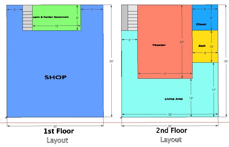

Hi,
Glad I found this site! Thank you in advance to all of the professionals providing free advice!
I am drawing up plans for a 30' x 35' two story building. Bottom floor is going to be a workshop, second floor is going to be living/theater area. I would like to keep my workshop open. However, from the small bit of knowledge and reading I have done I know that a 30' span is way too large for wooden joists. My question is, what are my options? And what are the cost differences between my options? I have attached a picture of the floor plan I intend to have.
Thanks for any help!
Jared[/img]
Your only option really is to divide the room with steel beams and then timber joists between the beams. Not knowing US code you'll need somebody local to do the calculations for you.
