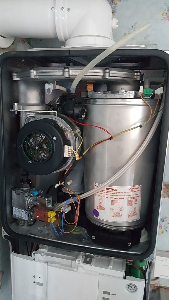

Junior 28i Issues after work
no air came out the boiler
where did you release the air from ?
i would advise ( because of forum rules ) you to get a REPAIR engineer out to have a look because it could be just a coincidence a fault has happened when the boiler was disturbed .

The boiler is 3 years old. The cover seal is not perished.
I'll be getting the work checked before we move in. I just wanted to fire it up, to know it's working again.
From this tube poking upwards, which is what the manual lists under filling procedure. Vent tube from heat exchanger it lists it as. Ensuring its pointed away from electrics (I put the tube into a bottle)
You can close the water flow from this tube, then there's a positive click as the valve twists fully shut. Assuming this shouldn't be left unlocked as it were.
