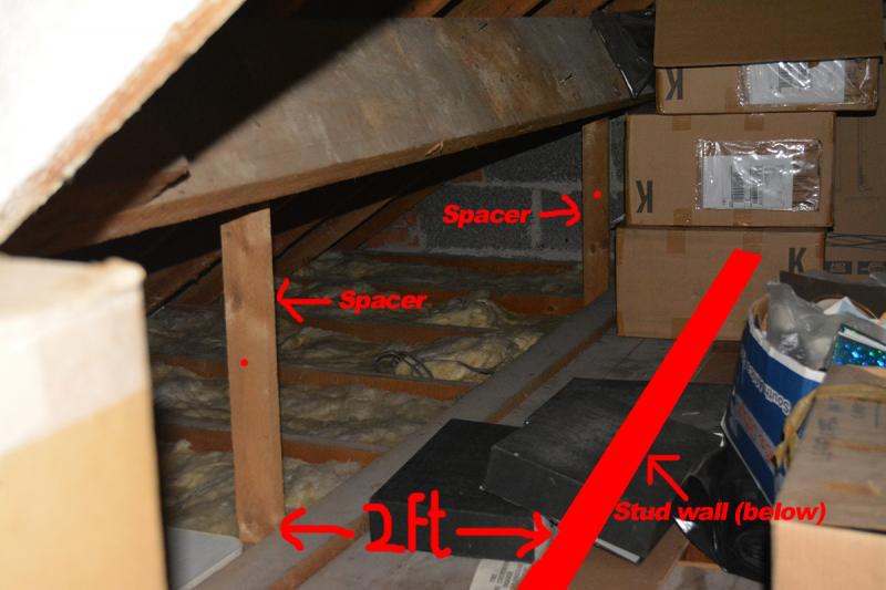

Hi,
I am going to knock down a stud wall. Currently it is 2 bedrooms which I want to make into a large bedroom. I have had a look in the attic and there are a couple of spacers between the roof joist and the ceiling joist. They are 2 foot (24 inch) from the stud wall and also 2 foot in either side of the stud wall. I have attached a picture explaining the situation.
My question is, is it safe to knock down the stud wall. Will I get any bending or arching in the roof?
Thanks in advance

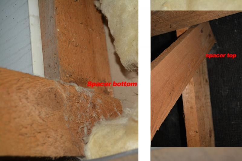

What you call spacers are hangers, which are nailed to the flat runner, which in turn is nailed to the tops of the ceiling joists. This helps to stop them sagging.
The stud wall below will not provide any significant support to your ceiling. If it did, the original builders wouldn't have bothered putting in the hangers and runner.

Thank you for your useful information. Should I check that the perpendicular joists are not leaning/resting on the stud wall before I knock it down? If they are what would you suggest?
Would I have I put hangers all the way along?
When they built the house the ceiling joist would have been there before the stud wall. The stud wall will be nailed to the ceiling joist only to hold it in its place and not to support the ceiling.

Ok, I am just a bit concerned that the stud wall supports the joists from sagging. Would this be possible as the joists are going perpendicular to the stud wall.
The ceiling joists could well be nailed to the stud wall but that doesn't mean to say that the wall is supporting the ceiling. They might have nailed the studs to the ceiling joists (or through a top plate) from below, just to stabilize the wall.
With that runner and hangers 2ft away in the roof, there shouldn't be a problem.

Ok, I was thinking the lateral wood construction in the stud wall may be supporting the joists. The hangers are 2 foot away from the stud however the runners are closer, one around 6 inch away from the start of the wall.
If there is a horizontal piece of timber at the top of the wall, immediately below the ceiling, it would have been nailed to the ceiling joists from below just to give a straight line for fixing the studs.
