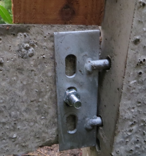

The cleat has two prongs which fit into the posts and a single bolt fixes the boards to the post. The fencer claims the posts can take all the weight and and the concrete gravel boards do not need to rest on the ground.

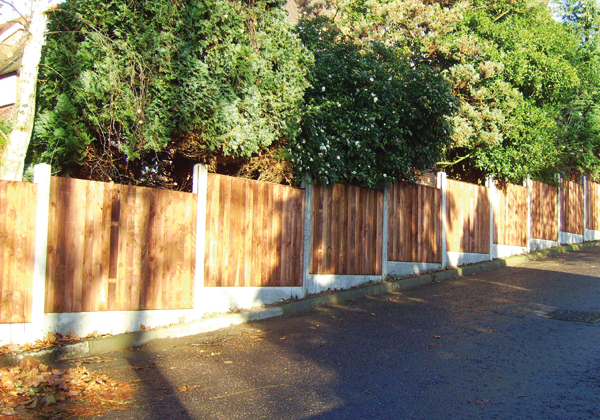

I have said it but will say it again for clarity. There is no issue with gravel board weight/ strength if installed normally. They do not need to rest on the soil for their strength they should just be partially buried or at least in contact with the ground for practical reasons such as animals and aesthetics.
On a sloping site you either step the fence gradually in which case the gravel board should be half buried at one end and level with the ground on the other or you angle the whole lot so gravel boards and top of fence follows the slope or an average of the slope if it varies.
These are the kind of decisions anyone with experience would have ironed out before starting. It sounds like he is reacting to problems rather than working with a plan.
It should be like this, and if the slope is too great then two boards should be used with one mostly buried

Regarding the strength you seem worried about, all significant loading on a fence is wind loading laterally, this is why heavy duty posts are well buried in concrete to stop it blowing over. The gravel boards are heavy but all the weight is acting downards and concrete under compression is massively strong, your only possible issue is the holes the cleats are in breaking but i dont know how they are detailed.

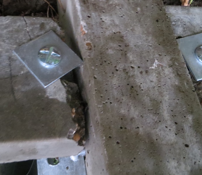

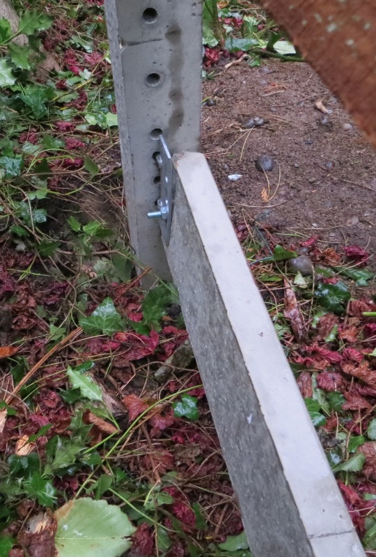

A sample of images showing the prong/post/board. Ground here is somewhat level. The board has been cut to fit. These most likely will need replacing. The others which are already in place are somewhat better 'looking'
