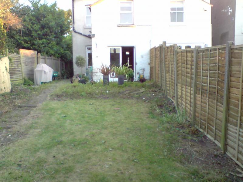

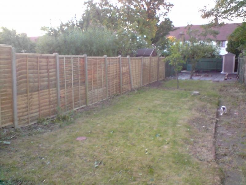

I have to say it really doesn't look like that now, please see photos below.
Do i need to lift the turf or can i just rotivate the whole lot at once? Have removed all the follage down both sides and am looking to put in a retaining wall at the top so need to flatten the top section by moving some down to the bottom section. Thinking of hiring mini digger thing to do this to make life a bit easier. Then sleeper beds on the left and right of the lawn.
Any advice greatly received.[/wiki]
Lift the turf - or else you'll have air pockets throughout that'll settle over time, unlevelling your new lawn.
Rotavate as you suggest then get some topsoil to level it all out. Leave it a couple of weeks to settle, then re-level, then lay the lawn.
