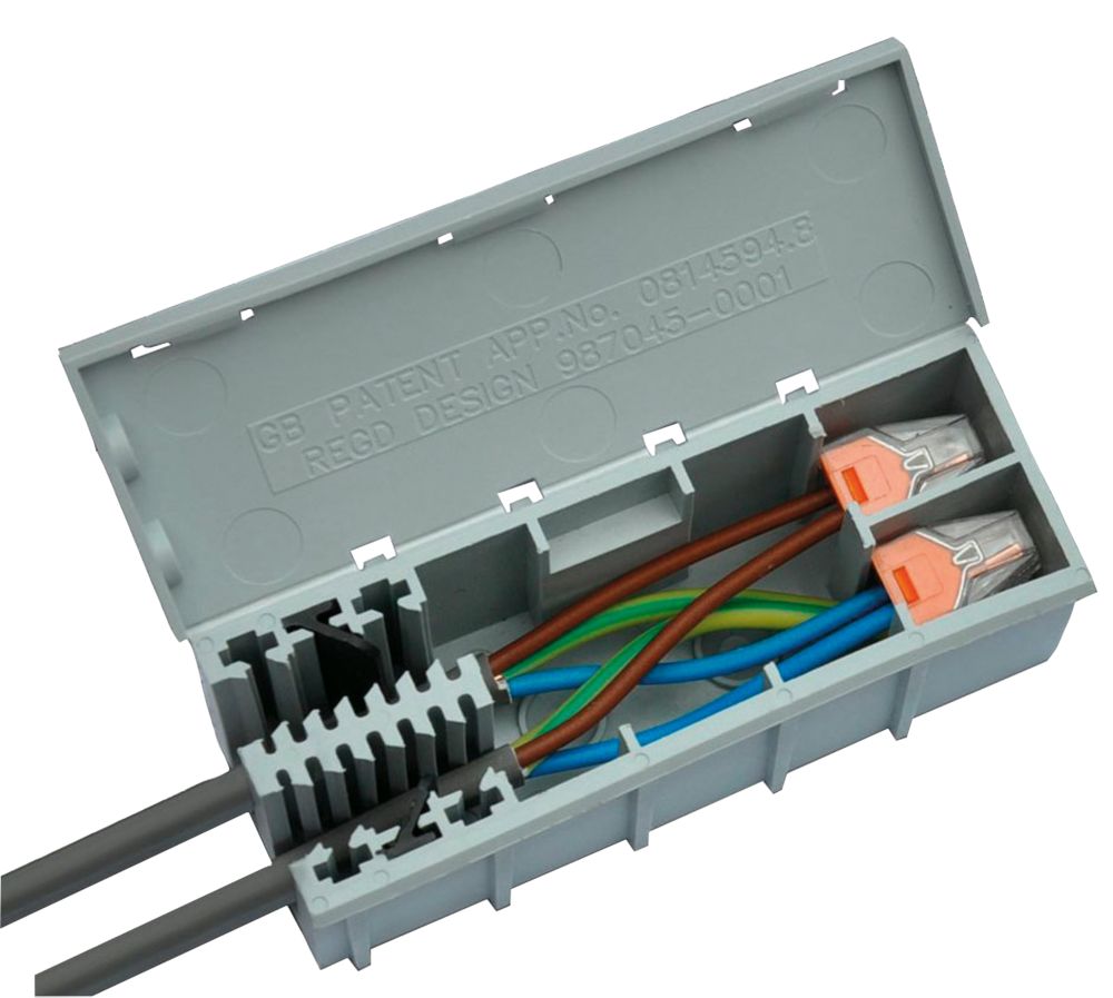

The Wago connectors are one way of making the connections. But remember that you will need to put the connectors inside an enclosure (WAGO make suitable ones for this!)

as for the connectors i think i may just use the normal connectors...do they need some type of enclosure or taping up...i have self amalgamating tape??

One of these Wago boxes as TTC suggested
or one of these
ae235
thanks Chivers

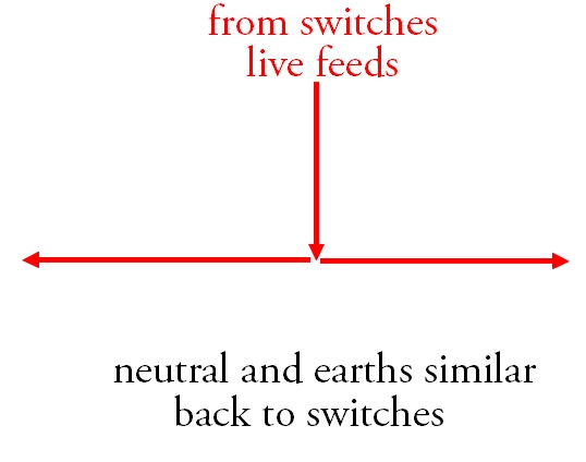

i will have to connect from the existing central light position outwards in each direction to reach the extra lighting positions...
they will be 4 feet from the middle, making 8 feet between the outer ones
i had planned to wire the outers to the inner as there is wiring there which goes to the switches
which seems i will have 3 liven neutrals, and earths all meeting at the central fitting
