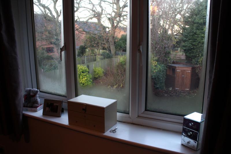

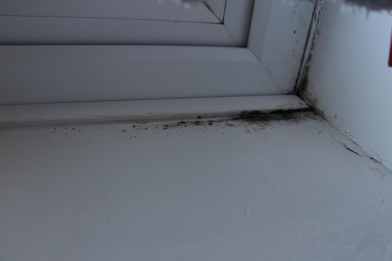

We are getting loads of moisture appear around the windows in both bedrooms. The wet only seems to appear when you wake up in the morning and has caused mould to grow within 6 months.
I'm aware that buying a dehumidifier would solve this, but I would rather fix the problem itself rather then buy something to stop it affecting us. The only problem is i don't know what would cause it, do any of you have any ideas?
I have attached a few photos of the amount we are getting.
Many thanks

The problem is that the windows don't have trickle vents and nor do you probably open them often enough.
The only real cure is to stop breathing when you sleep. Alternatively opening the windows a little at night would fix it.
Its condensation - as can be seen on the glass.
That same moisture is condensing on the cold walls and allowing mould to grow.
Vent the windows at night to get a bit of air moving. Or get some trickle vents fitted to the frame
If its a major problem and you can't ventilate, then line the window reveals and head with uPVC board. But then you risk the same moisture just condensing elsewhere instead
