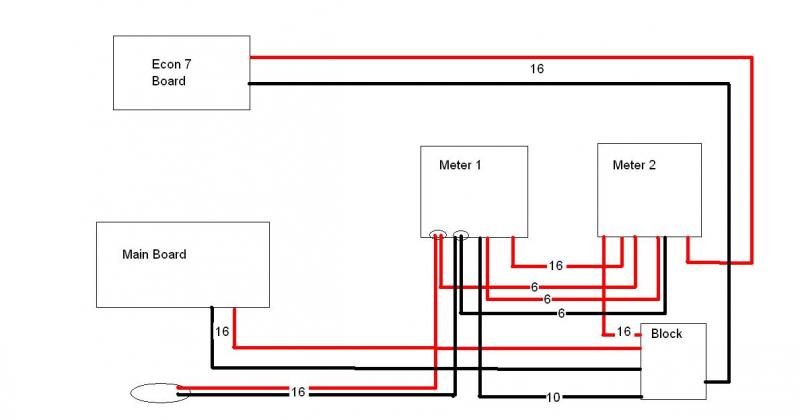

Hello everyone, whilst new as a contributor I do read this forum all the time and do understand the basics of electrics.
I have just purchased a new ground floor flat which has storage heaters and (I assume) Economy 7. I want to get rid of these but thats another story. As a matter of interest I have been trying to understand what all the cables mean in my meter cupboard (Diagram enclosed) I understand the block but what puzzles me is the link between the 2 meters, why are there so many and what do they do, could anyone enlighten me in laymans terms please. The sizes of the cables aren't necessarily accurate but represent the differences between each other.

The numbers do indicate the sizes but they are probably not correct, I put them in to show the differences between them all (ie the 6mm may not be 6mm but its smaller than the 10 - which may not be 10 if you know what I mean).

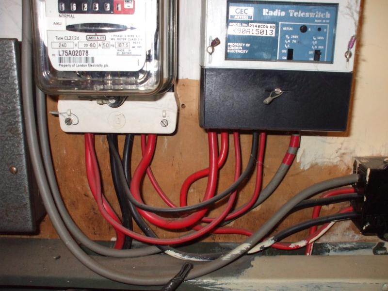

It is a standard econ 7 setup with dual rate meter and teleswitch.
All lecky is cheap at night.
It is wired a little oddly, looping the live from the meter via the teleswitch. It is usual to use a henley for this.
Not mush more to add, other than the DNO monkey was not very tidy.
ok, so from what I see..
the first meter ( on the left ) is a dual rate meter.. this records how much you use peak and off peak..
the second "meter" is the teleswitch this turns on and off certain times of day..
it has a red and black supply to it from the incomming of the meter ( the small cables) and a signal cable back to the first meter to tell it it's off peak time ( the other small red cable ).
the output of the first meter goes to the teleswitch on the very left big cable. the next big red cable along is the general use power, which goes to the general use CU via the block ( the neutral goes straight to the block from the first meter and on to the general use CU and the heating CU ).
the grey cable marked with red tape is the off peak power and goes straight to the heating CU. this is only switched on when the teleswitch says it's off peak time..
I see earths on the left though where they go to or come from I cannot tell..
we'd need to see the grey CU with it's cover off to see if / where your earth comes from ..

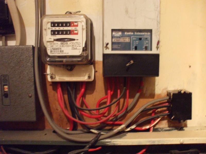

Holes in the top of the fusebox not sealed?
No grommets in said holes?
How smooth are the edges of the cut-out in the trunking where the tails emerge?
What's going on with that disconnected cable with tape over the end?
What sort of join is that in the cable just in front of the disconnected one?
Is there actually a main earth?

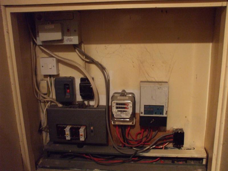

Thanks for the input, it makes more sense now. The earths you can see on the left - 2 go into the fused switch (thats for a heated towel rail in the adjoining bathroom), one goes into the econ 7 fusebox.
I still cannot see any sign of a main earth which is worrying.
I have arranged for the Elec company to come and put a new meter in next Tuesday and remove the Econ 7. They are also putting in an Isolator for future CU change/rewire (as recommended on this forum). I will ask about the main earth when they come.

you mean the red one that's the other disconnected one to go with the black disconnected one? they're both doubled back if you look BAS..
Doubled back and taped over is NBG if they are still live...
I'd assumed they were pulled out of the CU and taped up, but I can't see for definite where they run
Could the trunking be the earthing conductor supplying the installation?
that was my thought too..
presumably SWA from wherever the main fuse is ( bad design not to have a switch or a "dummy head" in the flat if you ask me... ), and it's made off into the trunking. using it and the coupler to earth the metal CU attatched to it.. ( again, a bad design, what's wrong with a nice cable to the banjo? )
