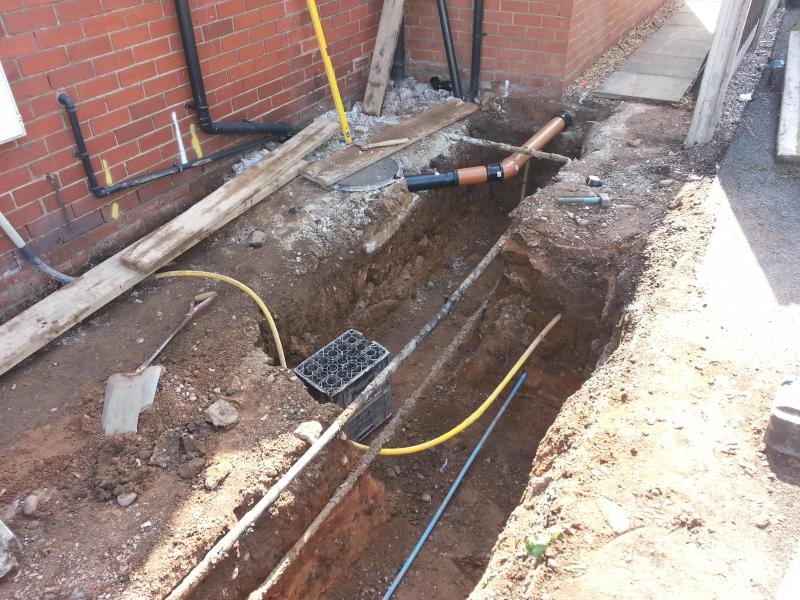

When we dig on domestic sites we are uber vigilant and are watching the front bucket like hawks. If I get chance I'll upload images from our most recent dig. We had four gas pipes (three of which turned out to be dead) one water and one electric service to contend with. Great fun!
I also benefit from having contacts in both gas and electric. Water I can deal with myself. Hit a fibre optic cable and you will end up re-mortgaging your house.
