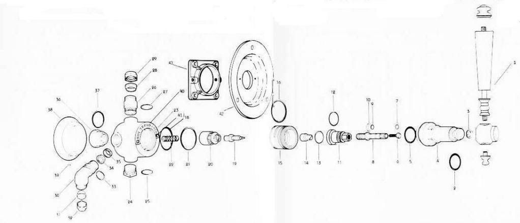

Hope thats what you mean, I have taken the picture off bathstore website. Thats where I bought the shower from a couple of years ago.
I stripped it down by removing the temp control then on/off control. That brings me to the valve body with the splines of the controls sticking out of the front. 3 screws release the innards from the valve body. I've done that and don't recognise a sealed cartridge or similar. It seems to be a series of ports controlled by the middle moving back/forward as the control handle is turned.
it maybe like the hudon reed and sirrus showers.
19 is the thermostat.
That looks very similar, and part 19 looks like a part in mine.
I thought that piece was just a brass rod, with a rubber sleeve over one end.
Is there something I need to check on it, or do to it?
i had one on a hudson red fail and i had to buy a new one.
but was no way of checking it or descaling it like a normal thermostatic cartridge.
did your just start running only warm ?
