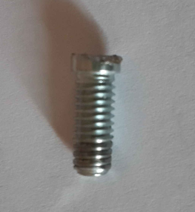

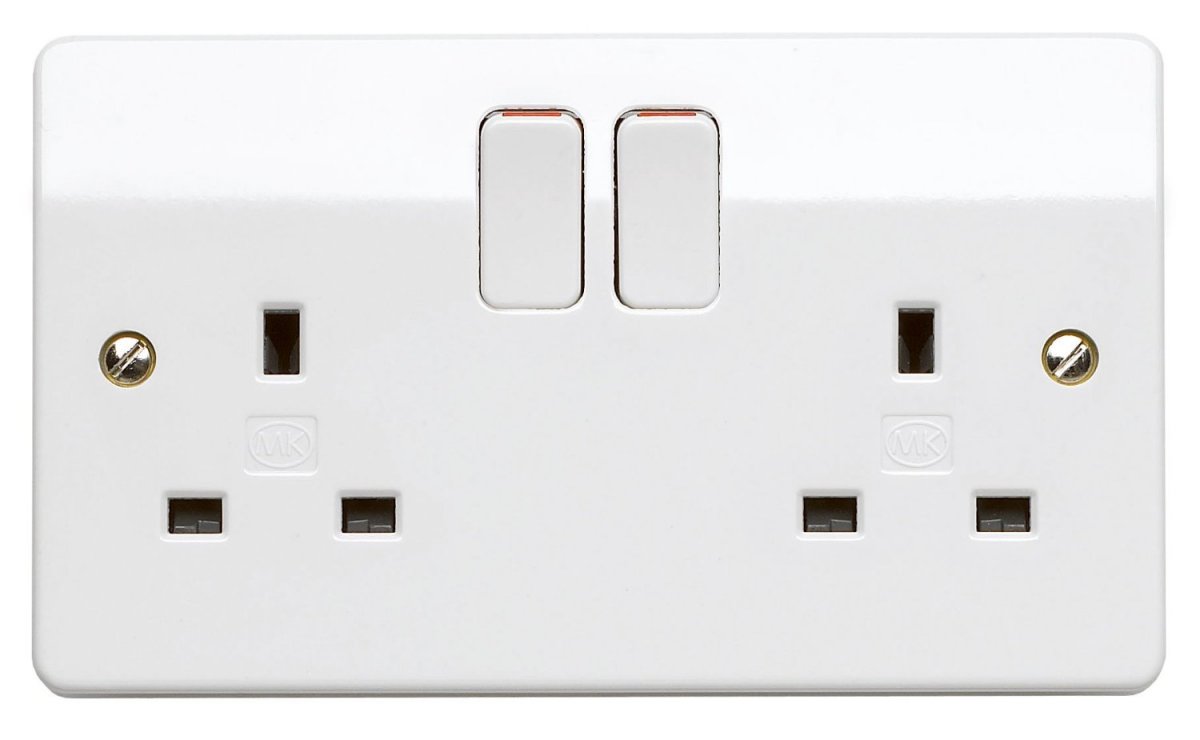

I am looking for terminal screws for MK logic plus double switched wall sockets.
Had a fairly extensive look online and cannot find them.
Have even phoned MK and they say they are not available.
They are a screw; of course they are available.
Screw measures approx m4.5 and is 9mm long.
Anyone know where to get?
ps not after the face plate screws that attach the socket to the back box

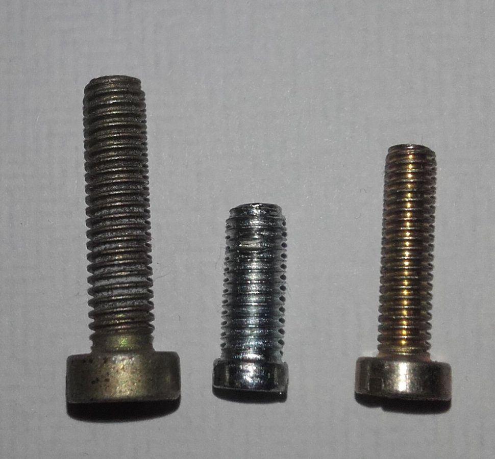

Indeed, I just took one out, they mangle the end of the screw so it can stay backed out in the packaging without falling out. It isn't 2BA which is too big and has a different thread pitch, but it is bigger than 4BA. It didn't match any of my standard metric dies, but was very close to M5, and the thread pitch was very close to 0.75 if anyone can identify it from that?!
Here it is between a 2BA and a 4BA screw.
