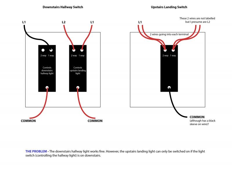

I've recently replaced the light switches in my house, but having a problem with the hallway and landing lights and wondered if anyone can offer some advice.
The hallway light is a 2 gang 2 way switch and the upstairs landing light is a 1 gang 2 way switch. The problem is that the upstairs light can't be turned on unless the switch downstairs is on (and vice versa).
I must admit, I know very little about electrics literally just mirrored the set up from the old switch I took off and baffled as to why it's not working.
I've created the diagram in the image below to show the current setup I have. Can anyone see the problem?
It's not working because you didn't exactly copy what was there before. For example, did the old 2-gang switch have its terminals arranged like the new one, or was it like this:confused:
Were there any wires linking terminals?

Hi,
Thanks for the response. The old switch had its terminals arranged with L1 and L2 as you illustrate in your diagram. I labelled the wires with the terminals that I took them out of but obviously this doesn't directly correspond to the setup in the new switch.

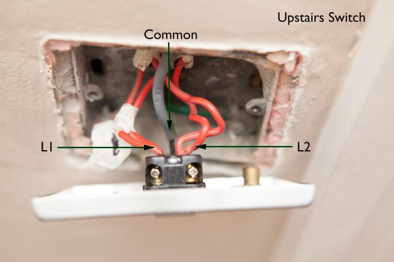

Photos would help as well, as I imagine certain wires come from certain cables - and your diagram doesn't show this.
Or, you could describe where each wire emerges from.
Post a couple of photos. I bet we can fathom this out between us.

Hi guys,
As promised here's some photos. I had a little difficulty with photographing the downstairs 2 gang 2 way switch whilst the wires were connected as one of the wires (labelled L2) is very short.
Here's the downstairs 2 gang 2 way switch connected and below another photo showing the wiring without the face plate.
As for upstairs:
Not sure if it's of any help, but I also photographed the back of the 2 gang 2 way switch.
Just to clarify the problem that I'm having:
The upstairs hallway light should be able to be controlled from both the downstairs and upstairs light switch. I can turn the light on and on from downstairs, or on and off from upstairs.
However, if I use the downstairs switch to turn on the upstairs hallway light and then turn it off using the upstairs switch, I can't then turn it back on using the downstairs switch. I would have to turn it back on upstairs.
I hope this makes sense.
