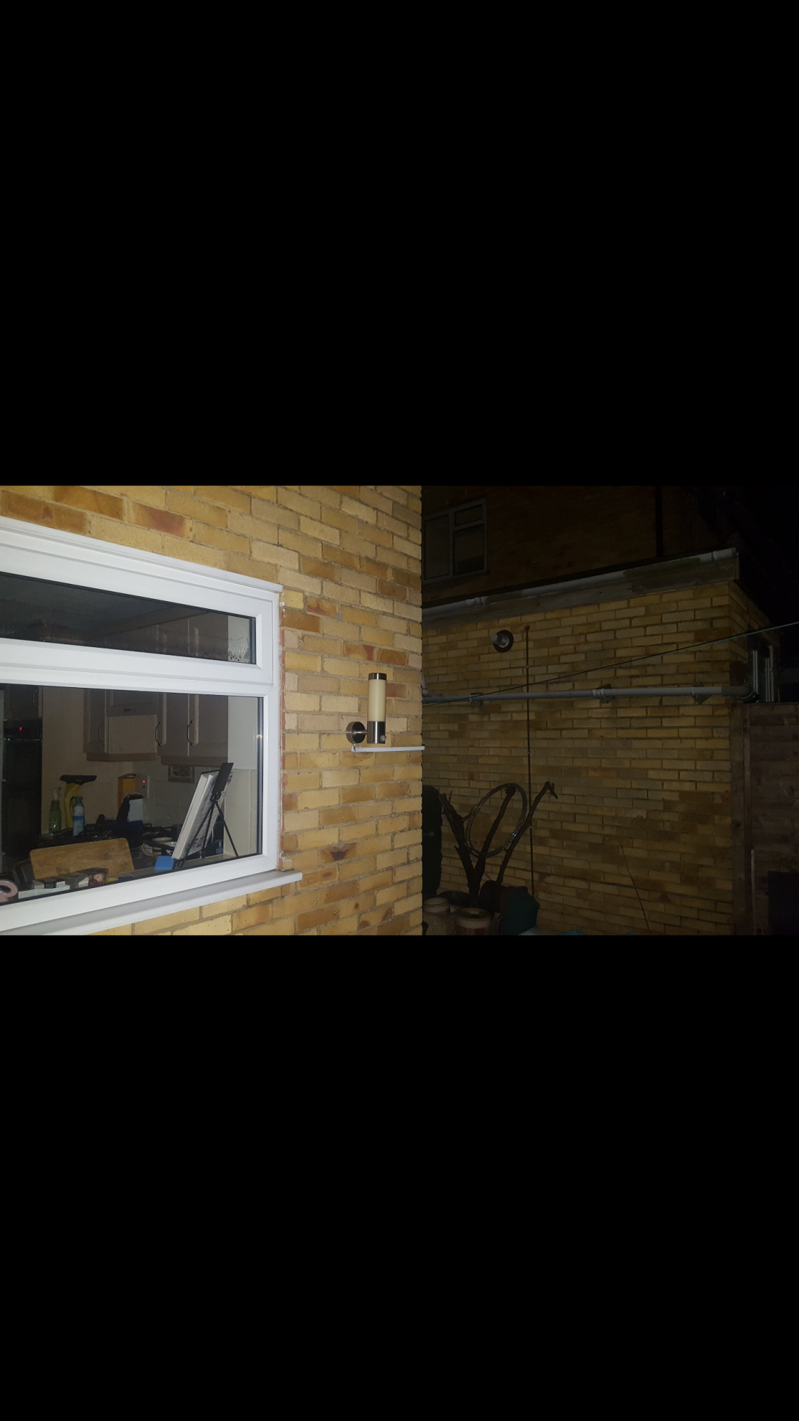

Hi,
I've searched through the forum and found lots of useful half answers and a few suggestions...
We bought the house about 9months ago, we've had a builder friend round recently as we were looking at options of extensions etc, when he saw the flue he laughed and said that shouldn't be there but couldn't offer much more advice at the time.
The next door neighbour had the extension done about 6-8yrs ago according to another neighbour.
Should their flue terminate there?
Is there anything I can do legally as this may hinder our plans for expansion??
All this is based on the neighbour not being amicable about the situation but he might well be. I'd like to go and have an informed discussion with him rather then me not having a clue.

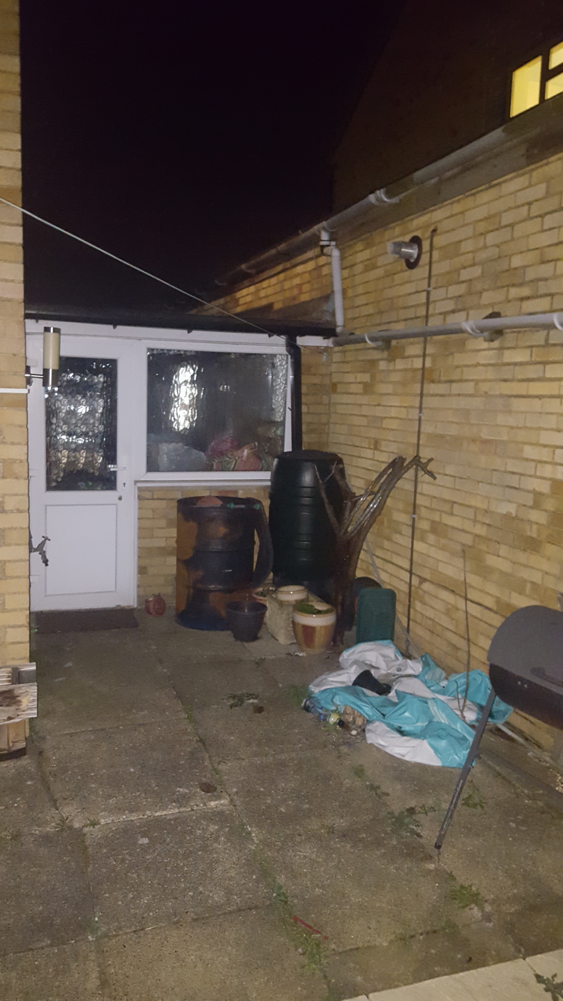

One pic is from my kitchen window looking at the flue and the other is showing the back of my garage with flue and over fill?? copper pipe.
The drain pipe is something to bring up another day.
Looks like a Suprima flue from the pics so the boiler is older than 6 years... But that's not to say it wasn't relocated, but that would still be against the regs.
No, the flue shouldn't be there. It's technically trespass, will be interesting to see your progress, so keep us posted.

Is there a flat roof above it?
Scrap that I can see the pitch roof and besides it will be too close to the boundary for the clearance requirements so your neighbour is screwed.
Yeah it's a flat roof, just has a small up turn near our side.
