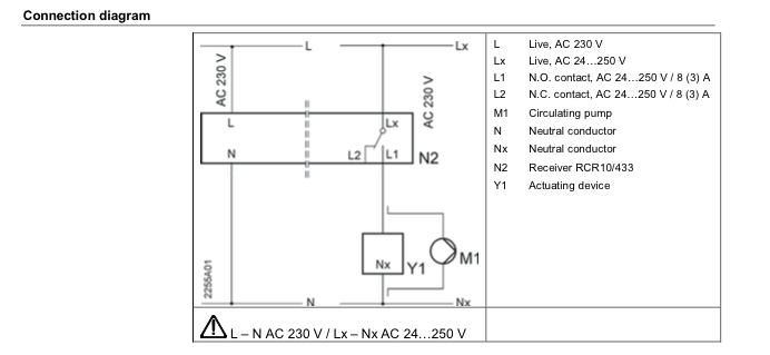

Hi All
I currently have an oil boiler in the cellar of the house. Connected to the boiler is a Siemens RCR10/433 and a wireless thermostat RDH10RF.
Have have uploaded the image for the wiring of existing thermostat and wondered if any of you smart guys out there could tell me where I should be wiring these in on the nest. Especially as I have read some part talking about using a bridge cable between 2 terminals .
Glenn
Thanks Muggles
Take it I just ignore the nest T1 & T2 cables as the nest will be on the stand plugged in
Thanks again
Yeah, don't connect T1 and T2 to anything other than Nest or you'll need a new Nest
