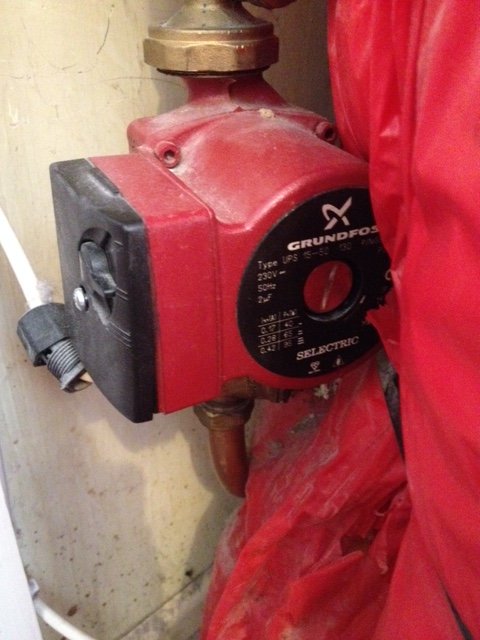

Sounds like your engineer's mind is fairly blank if he's trying to cure vibrations by replacing electrical components, and it also sounds like he's bu99ered your programmer... it'll be something mechanical - the pump would be a good place to start. Probably looks like this
See if you can find it. If you can, turn the hot water on, wait for the noise to start, then move the lever on the black panel on the side to a different position. Does the noise change?

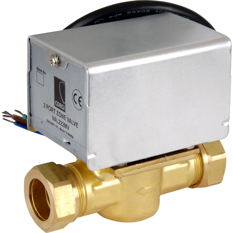

As the heating is working and the boiler doesn't fire when HW is selected, it is likely you have an S Plan system (with 2 motorised valves) and the valve actuator for HW is bust.
If your system is 'S' plan, you will have two of these, one for heating and one for hot water, located near your hot water cylinder.
If it's 'Y' plan, you will have one of these, for both HW and CH, again usually in airing cupboard near hot water cylinder.
Check these for faults - burnt out head, fitted wrong way round or seized up!

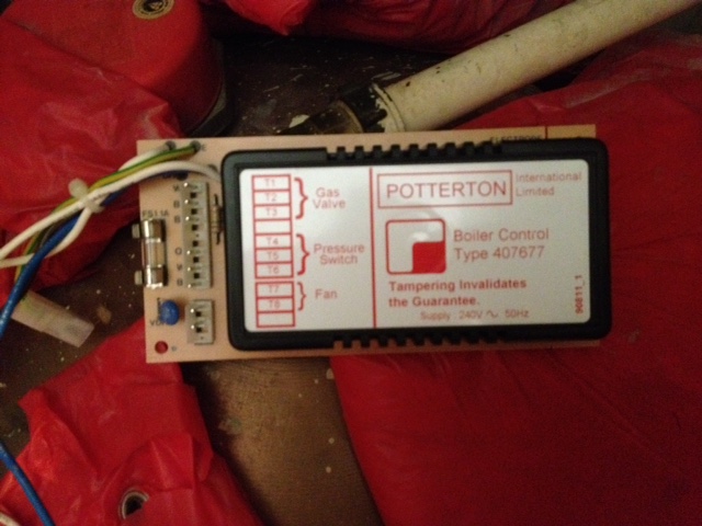

The boiler control hasn't been reconnected as I thought (please see photo), so I am unable to check if the central heating still works. It's been off for a couple of months (we turned if off), but worked fine.

The pump is the same as the photo muggles posted. I moved the lever to the three different positions (it was in the middle position), but the noise remained the same. I don't know how reliable a check this is at the moment though with the boiler control being detached!
I've probably got the terminology wrong, but the gas engineer mentioned pcb a few times. To be fair, he said he's never heard a boiler make this noise before, so he's being honest about not really knowing what it is. Like Echo the husky said though, we don't want to be replacing parts as it could get expensive (especially because my parents are hoping to move soon). The last expense they need is a new boiler! I just want to ensure it's safe for them.

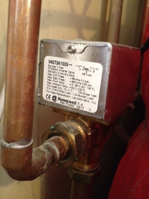

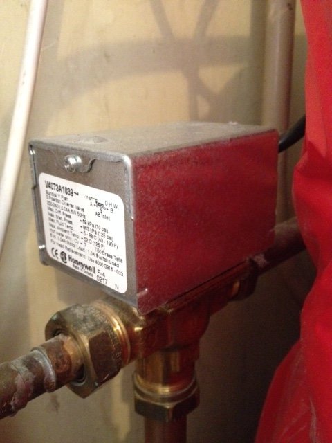

I can only see one Sundial Y plan (please see photo) which is situated above the motor.

Pity you didn't video with sound while you were there... This is intriguing! If you took the head off of the mid port valve and manually operated it, you could see if it was sticking!
