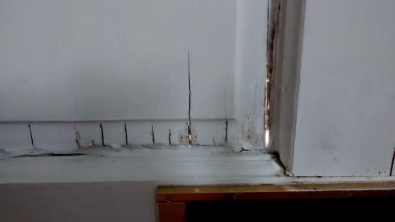

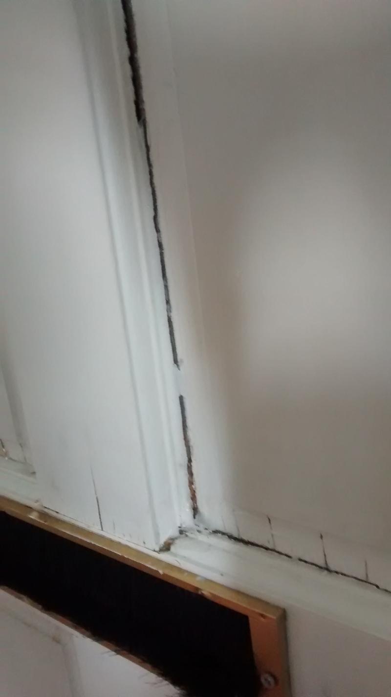

no rot anywhere from what I can see - just shrinkage of the panels from the rails. There are gaps which I can identify cars through.
no flaking paint and well not sure what else I could do. The door was here when we got here 15 years ago but suspect it's no more than 20 yrs old.

show us a photo of the old door. I'm interested in the cracks that I could see a car through.
How was it painted, and how often?
Full(er) story

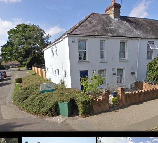

we bought the house in 2000. Door was already in. In 2002 we extended the house and relocated (or at least the builder did) the door to the new front of the house. We decided not to change the door as we were towards the end of the project as a job offer from Australia took our eye off the ball. We (or rather the mrs) killed the emigration offer so we were left with the old door.
Pictures of the old door are as below.
It gets a lot of sun and naturally is open to the elements. Also we noted water was getting in under the bottom which has damaged the flooring so I need to get it changed soon.

On your old door, the cracking of paint where the panels are grooved into the stiles happens because the panels are free to move independently as they expand and contract with the weather. They're supposed to. The more paint is there, the more it will crack and the worse it will look. If you oil any exposed timber in hot dry weather with a tiny paintbrush, the exposed part will look fine.

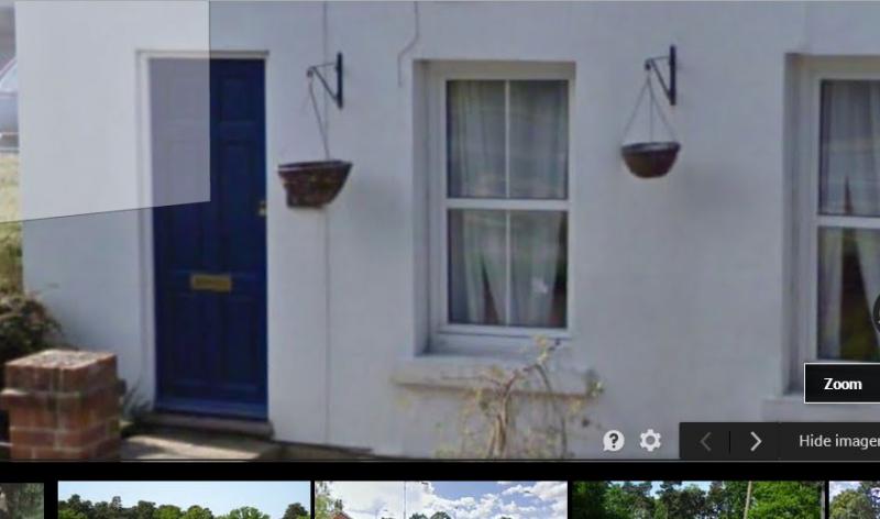

You have a period property with original sash windows. Putting on a modern plastic composite door will stick out like a sore thumb in my opinion.
You may be able to get a design that looks period, but it is all about the feel when you enter a property.
Composites may have their place, but I think it would be a shame to replace wood for composite on a place like that.
