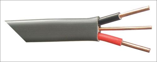

Is the switch meant to turn on just that one light?
Are these single wires, or are some in a twin and earth flat cable?
Are there any wires that you have not noticed which may be trapped between the fitting and the ceiling, or in the ceiling void? Turn off the power before you look.
The earths must be joined together, and must be connected to the earth terminal on the light if there is one. If the light is double insulated earth is not required. Check first. Should say on the light or the box or the instructions.
Have you another red tucked away in the ceiling?
Any means of testing for continuity and for live conductors? IE a two pole voltage indicator or multimeter

On first impressions it would seem there are wires missing, but you say single wires as opposed to cables containing two or more wires?
Can you send photos so we can be sure exactly what you have?
