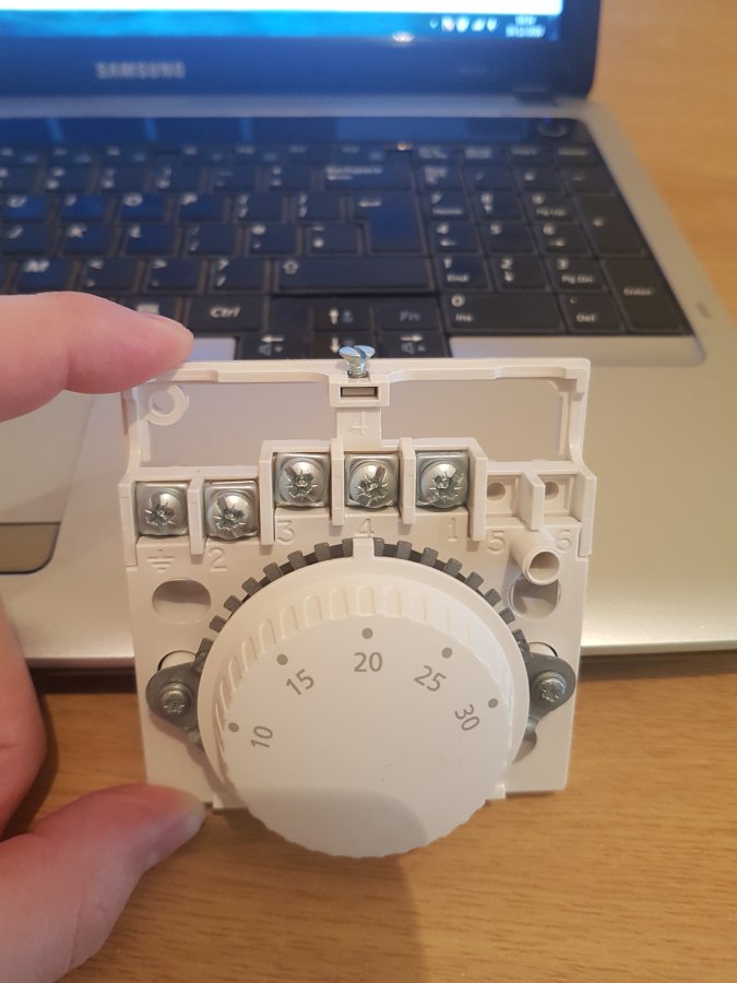

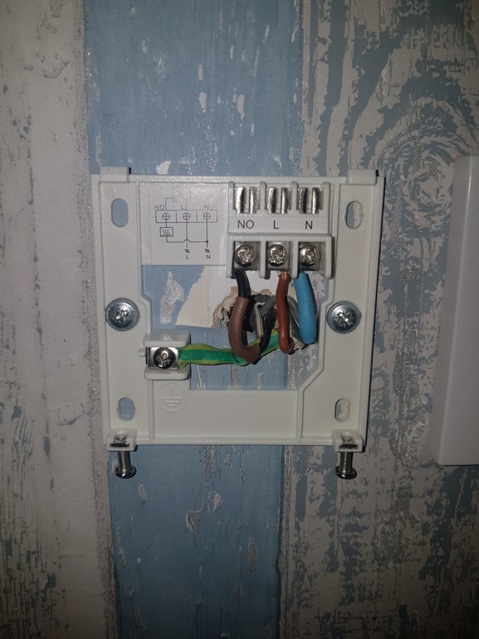

Hi
Could anyone possibly tell me what wires on the Newlec Room stat (old room stat) go to what Terminals on the Center Room Stat (new room stat)
I have been told my old room stat is broke as when i turn the room stat down it goes off but the clicks straight back on.
I have enclose picture of both stats. the 1st pic is the old stat and the 2nd pic is the new stat.
Any help would be appreciated.
Many Thanks
The brown L wire goes to 1 on the new Honeywell stat.
The blue N wire goes to 2.
The black NO wire with brown sleeve goes to 3.
The yellow/green earth wire goes to the left hand terminal with the downward arrow.
Hi
Thanks for the reply. The new room stat is not a Honeywell its called a centre EHE0200155 model.
Is the wiring still likely to be the same?
Thanks.
Sorry I should have explained that it is just a Honeywell with the Plumbcenter brand. The stat is identical to the honeywell branded one so the wiring still applies.
