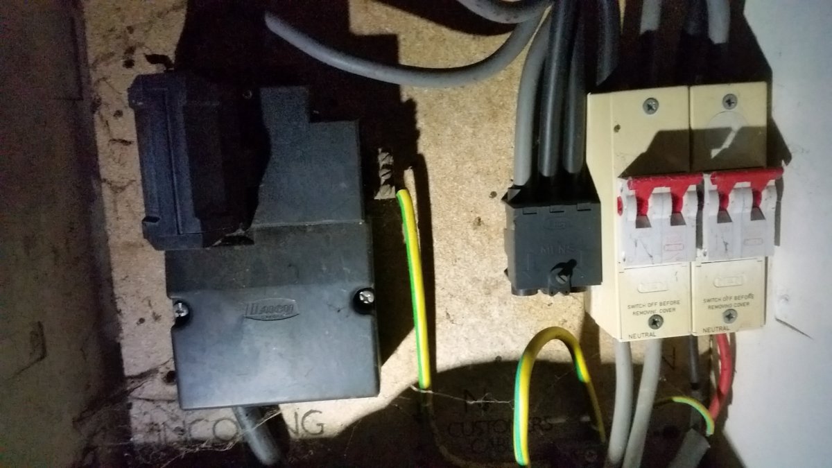

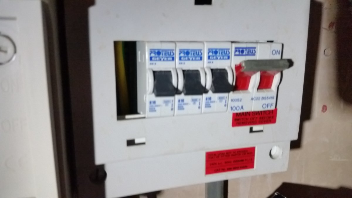

have a look at the meter(s) and the timeswitch or teleswitch and consumer unit, post some photos.

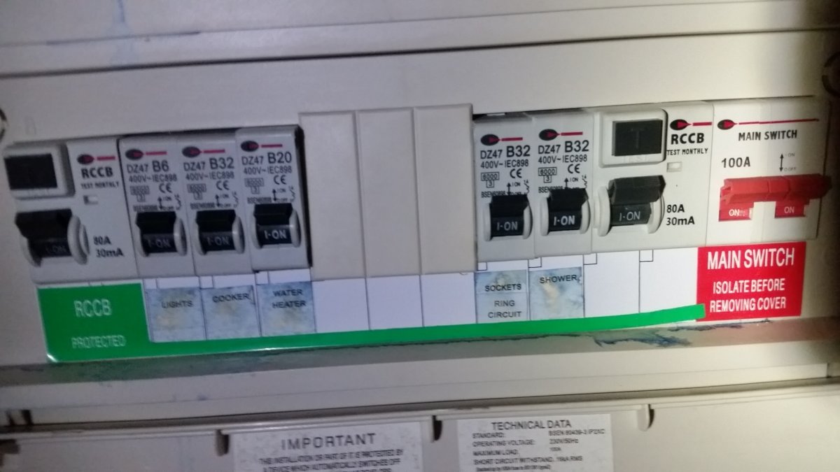

Photos of what dude? I've checked the fusebox all OK the meterbox looks same as usual so I dunno..
we haven't seen them, so how do you expect us to spot anything?

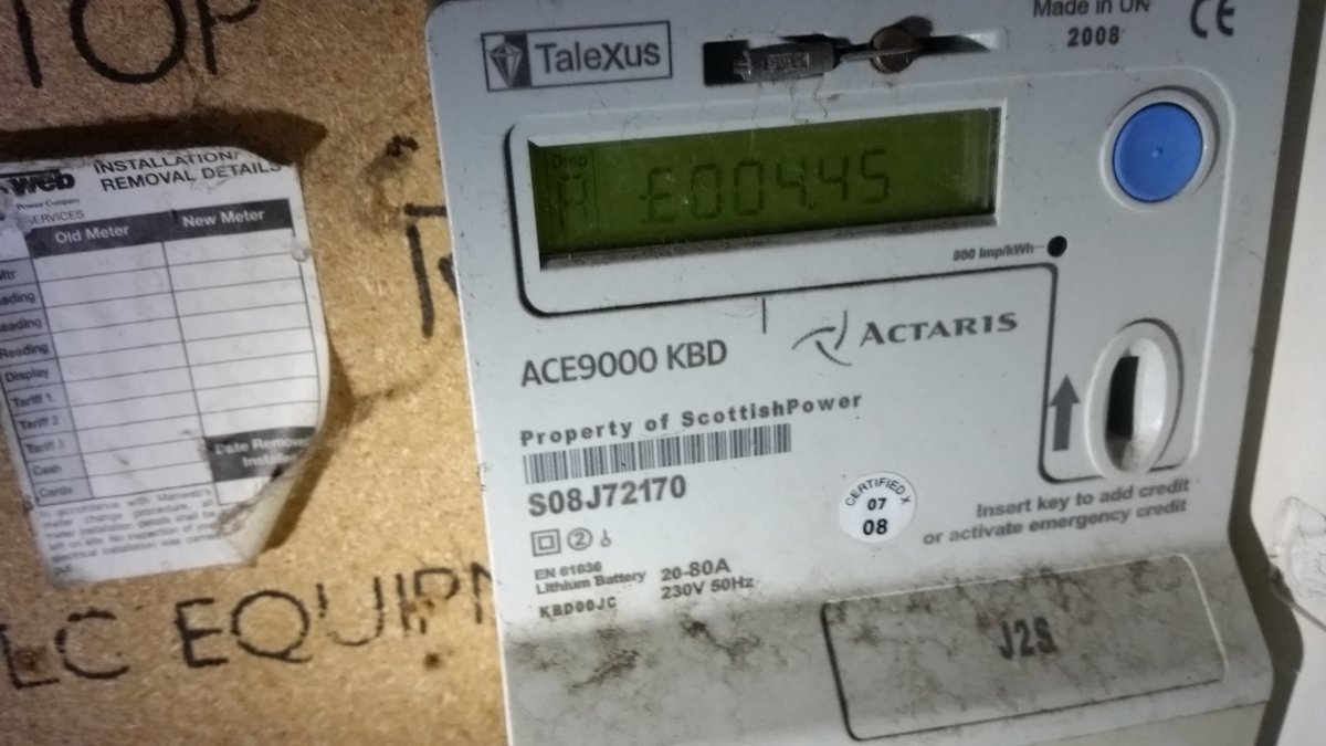

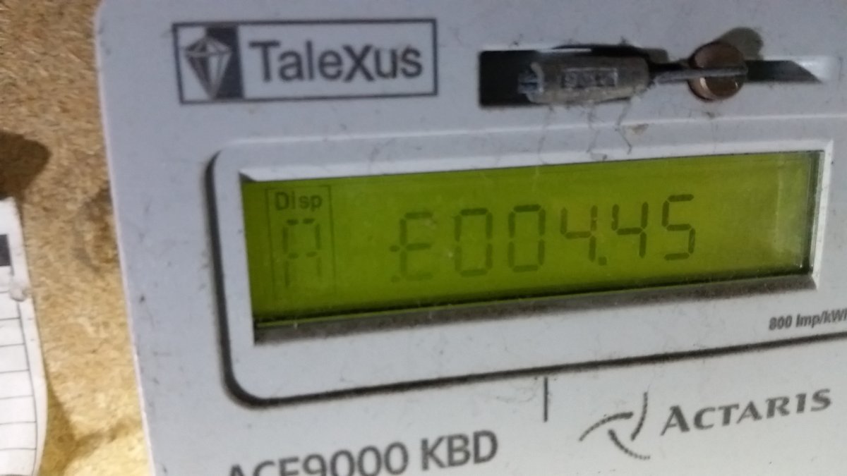

can you see a grey (?) box connected to the meter? There should be something providing the time signal to switch the night rate on. Unless it is embedded in that keymeter somehow, which I have not come across before. Usually it is a radio clock that picks up a switching signal.

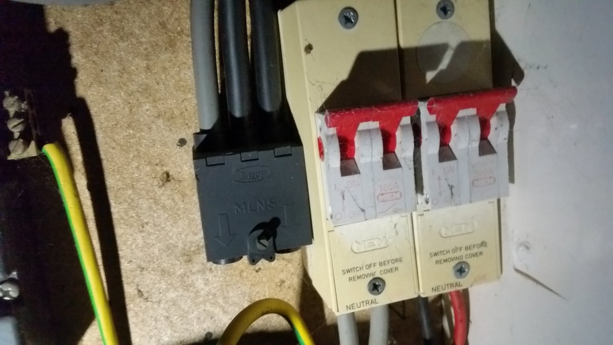

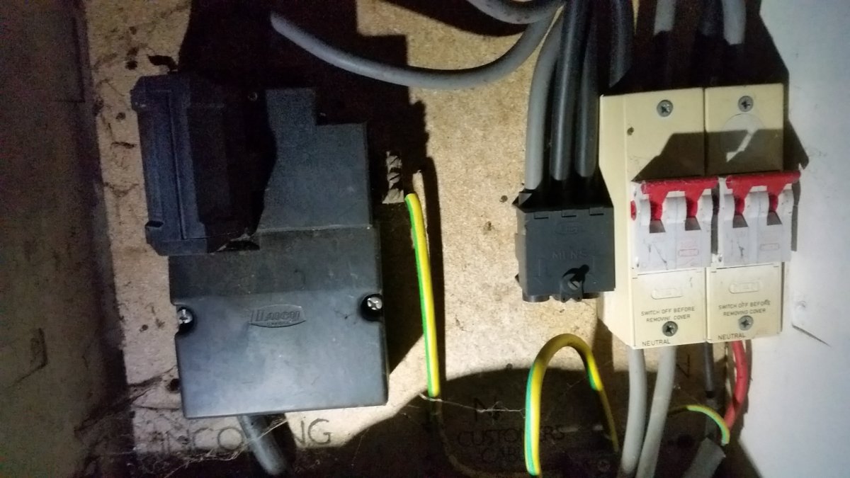

Please photograph the cables around and between the meter and the CU, may give some clues, to see where they go.
The meter is dated 2008 so probably no new technology.
https://en.wikipedia.org/wiki/Radio_teleswitch
If you are in an area that can't pick up BBC Radio 4 on long wave, you may not have one.
Some old installations have an actual timeclock with a visible dial.

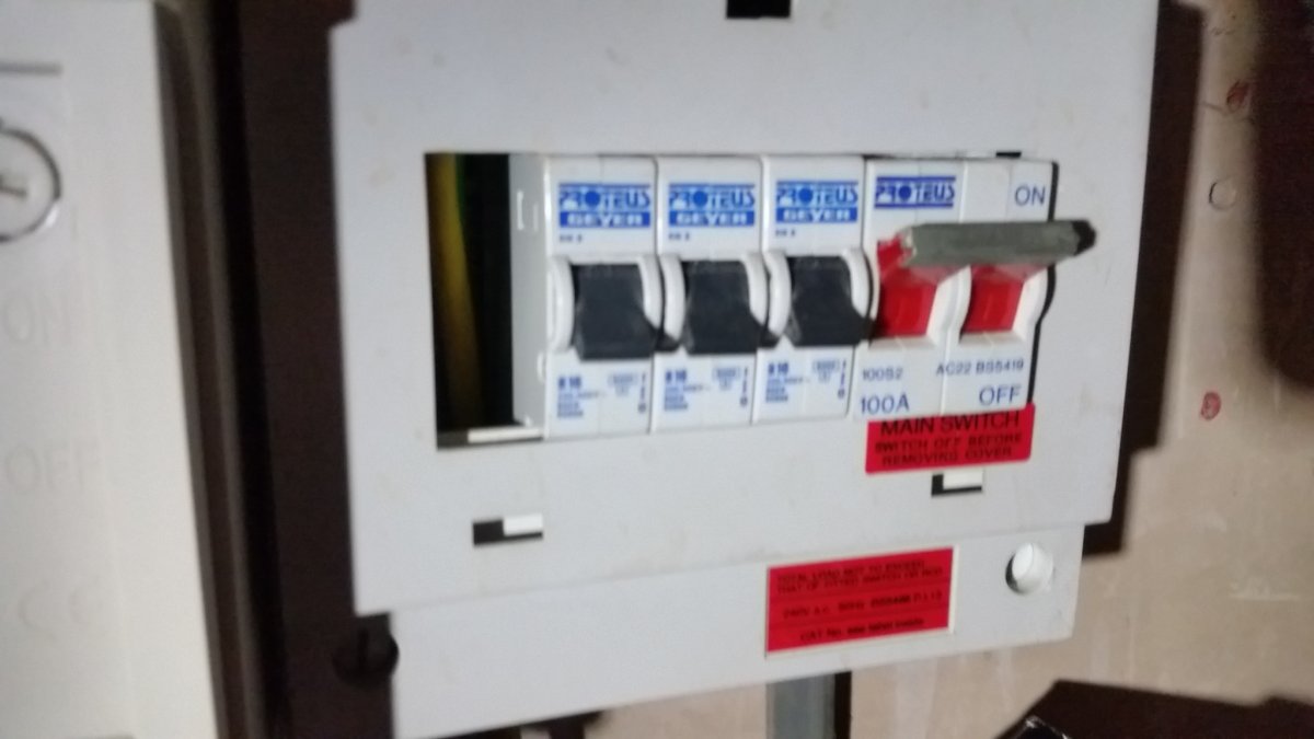

Well for a start all the circuit breakers are off in the Proteus off peak board! There also needs to be a blank fitted in that spare way!
OK just put the breakers up. What do you mean blank fitted in that spare way? Cheers for the help BTW
