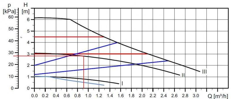

Not a bad guess ;) ; according to the manual, the smallest is 11.7kW
It also (page 12 para 3.2) gives the water resistance for an 11C temperature rise. So we can safely assume the boiler is designed for an 11C rise. The flow rate will therefore be:
11.7 / (4.18 x 11) = 0.254 litres/sec = 0.92m³/hr

Not really, you will have a permanent heat leak back to the boiler. It would be better to set the pump to a fixed speed and adjust the ABV so it only opens when necessary.
I assume you have a thermometer. If so, open all TRVs to max and adjust the pump speed so you get an 11C drop (or as close as possible) at the boiler.

I get the temp difference at speed II. My ABV is one of them:
http://www.toolstation.com/shop/p36612
EDIT: I would prefer the variable speed if it makes any sense.
I get the temp difference at speed II. My ABV is {a Salus}.
I don't have instructions for the Salus ABV, and there are none on their website. This diagram shows what's needed:
Click to enlarge
The vertical red line is the flow of 0.92 m/hr; the horizontal red line shows ABV so it only opens if the pressure exceeds that amount. Fortunately the control line at speed 2 is almost horizontal, so it will never open very much.
