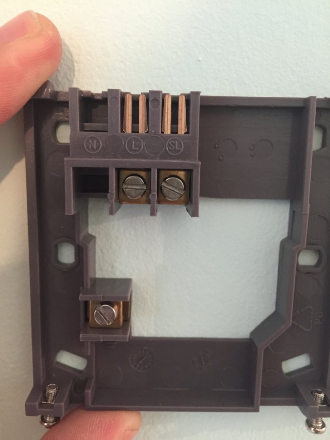

Old for new thermostat however new thermostat only has 3 connections live sl earth

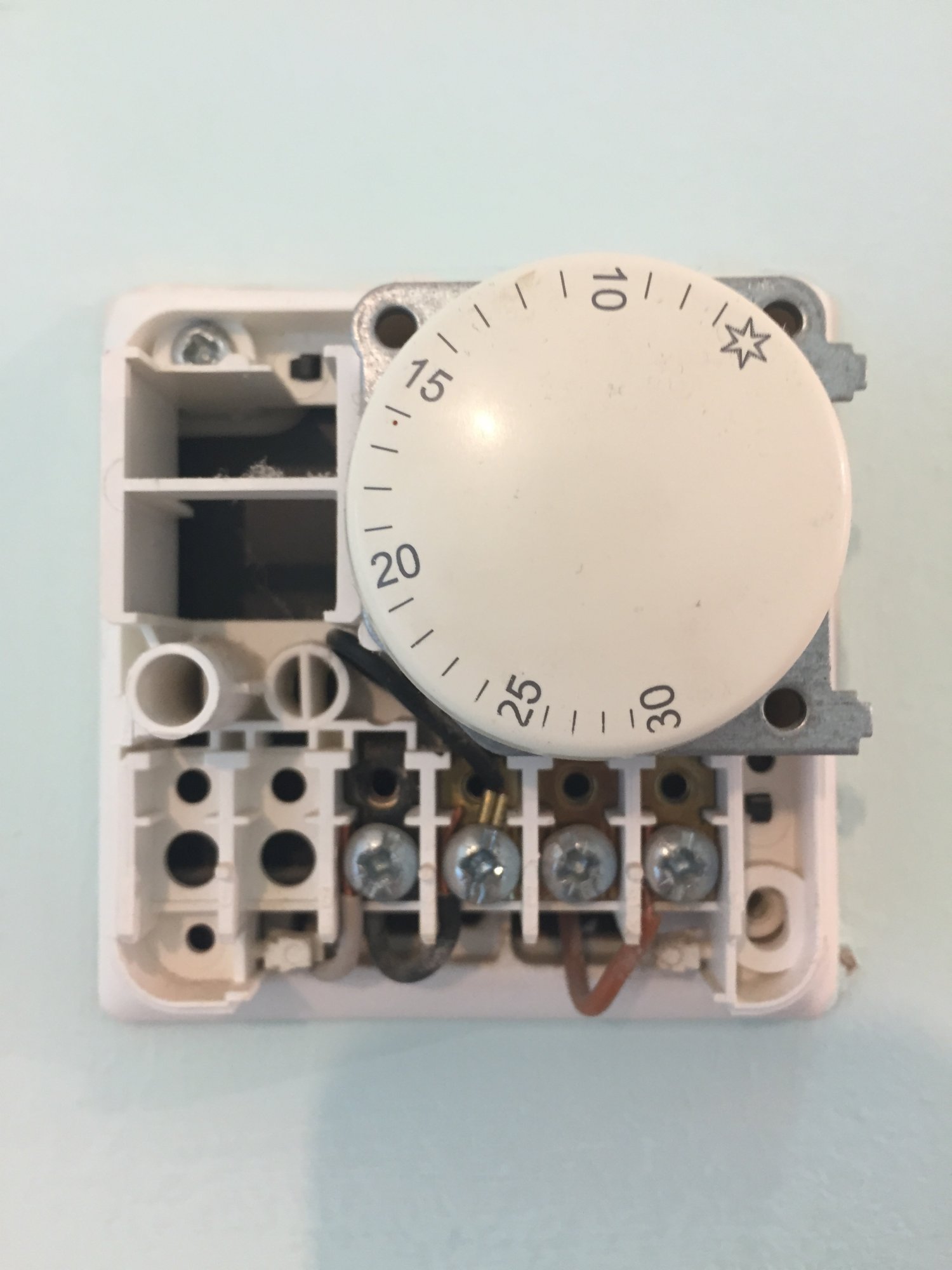

Old thermo has a grey wire what is this for and what terminal should it go too ?
you would be better posting models of old and new thermostats for the correct advice very few modern thermostats will have an earth, just because it is a green and yellow wire on a heating system does not mean it is an earth
Hi the old thermo is
Myson
Thermostat MRT1
230v 50hz
New 1
Salus
Digital electronic
Thermostat
Model RT300
Regards
OK the wires on your old thermostat the two wires you need are between terminals 1 and 3 the other wire is a neutral as your old room thermostat has what is called a heat anticipator , you do not have an earth , your new receiver needs a live and neutral to power the unit then the two existing wires are your switch
New back plate
The old wires are on terminals 1 and 3 and they go to L and SL on that back plate doesnt matter which way round and isolate the other wire cut and tape it up
Red/Brown wire (T4 from left): connect to L
Black wire (T2 from left): connect to SL
Grey wire (T1 from left): not used. Make it safe in a small terminal block behind the thermostat.
Thanks ianmcd & dhailsham thats it fixed and working now
