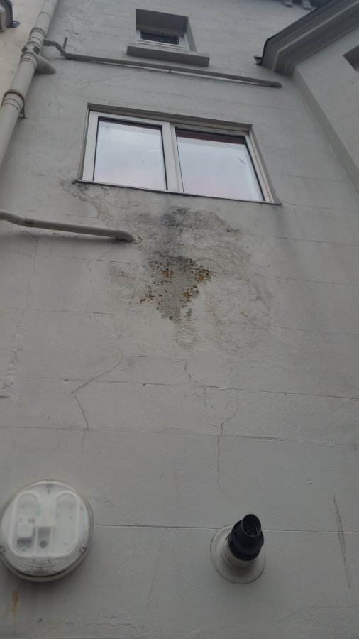

Wall has been looking like on the picture since this summer.
Not better, not worse.
No Damp inside the flat.
What should be my point of action? or who should I call for as a trade man to get that wall check out?
With any defective render or paint, water gets behind it, and then soaks into the wall and has difficulty getting back out. It will only get worse, so sooner is better than later. Water can take in salts or cause salts to form in the wall which then cause problems with render/paint in the future.
It looks like the cause of this is that window cill above. Its not projecting far enough out to cast rain off the wall. Rather the water is just running down the wall constantly.
You need that cill sorting out before any repair to the render or paint
There's obvious minor damage to the render above your flat and to the left parallel with the soil stack.

As advised above ref the cill. If you look to the window cill above your flat you will see that they have installed a projecting concrete cill.
Your window would also benefit from a "drip hood" above it.

As "Woody" the sill could be a factor, if you look at the damage it appears that the disturbance of the paint is occurring from the left hand side of the sill??
Suggest you consider looking at the Sill and is it level, or? is is sloping to the left??
One other long shot is that there is a leak on the pipework that is in the middle of the damage area?? the leak could be within the wall and the leaking water could be damaging the external wall paint by saturating the wall??

1. Window Fitter - take out window and re-fit with a deeper sill profile. (you might be able to fit a simple aluminium drip/flashing with the window insitu but will look naff)
2. Painter and Decorator - prepare and paint the wall.
Also worth checking that waste pipe isn't leaking.
I used my all encompassing phrase "prepare" which covers everything from going over it with a stiff brush to knock down the entire building and rebuilding it from the footings.
