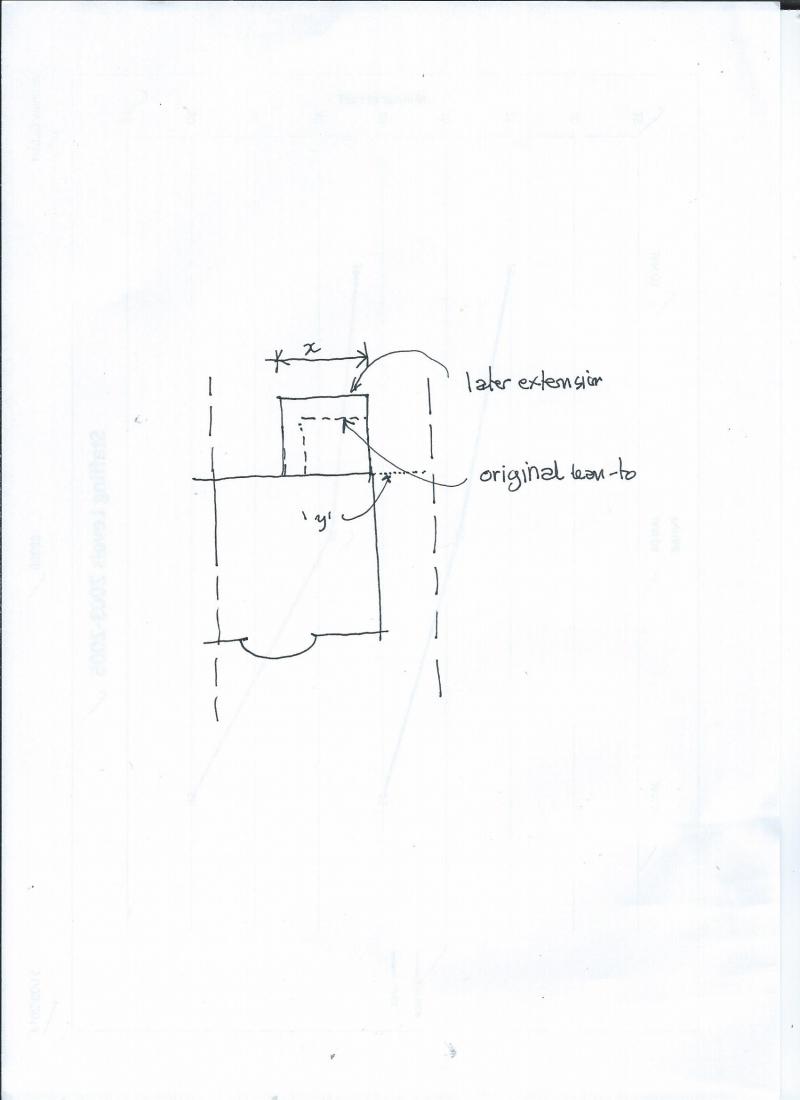

Assume you are in a semi, as sketch?
If the dotted line represents the original extension built with the house, is the outline of the enlarged extension showing correctly?
If that's the case, you can extend the side of the house (to not more than one-half the width of the house) but only as far back as the line marked 'Y'.
The reason is that if you go back any further, your new side extension would be physically linked to the later kitchen extension. For the purposes of p.d., the new side extension and the later kitchen extension would be regarded as one unit.
Viewed from the back of the house, the combined width would then be greater than half the width of the house, therefore it would not be p.d.

Yes layout is as per your diagram. So we can only come back as far as the Y line? I was hoping we could come back as far as the rear of the original lean to - is this not regarded as the rear of the original house then as that's the footprint as of 1948?
So if I can only come back to the 'y' line, and considering the end game is to get back as far as possible to the rear of the later extension, would I build back to 'y' and then apply for permission to extend further backwards to the rear of 'later extension'?

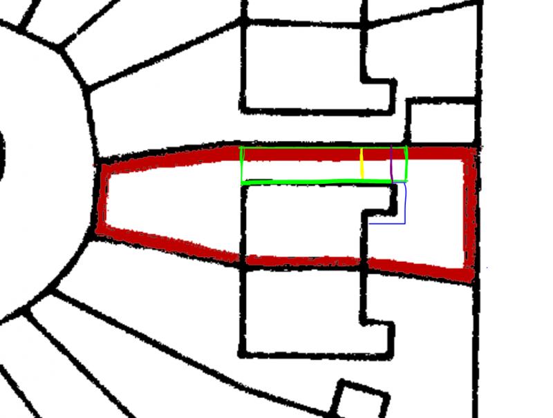

Freddy, this is the current plan view from the land registry.
Blue line is how it looks now,
Green is ideal extension extents, we could live with coming back to the purple line as we'd only lose a couple of feet. If we can only go to the yellow line, could we then apply for planning later to extend this rearwards to the green line.
Hope this is clear :)[/img]

Thanks Freddy, but doesn't the blue line mean I already have a rear extension? Which would mean that the side extension, if extended beyond the rear wall would be attached to the rear wall (black line is 1948 footprint as far as I can tell) as per first diagram on page 23 ?
I think overall width at widest point then would > 50% width of original house.
So is the consensus that I can come back to the yellow or purple line? Or is the best approach to get the complete green extension to just come back to the yellow line and then get permission to come back to green/blue line?
Cheers
Cheers
Yes, your best approach is to build the side extension first, and then apply for p.p. to complete the rear part.
In this particular case, it would be better not to apply for p.p. for the whole lot. The reason is that in Trafford, planning policy requires two off-street parking places per dwelling. Looking at the site plan in your case, you won't get two places without setting the front of the side extension back a good few feet.
But if you build the side extension first under p.d., - and up to the front - they can't later refuse a planning application for the rear part.
