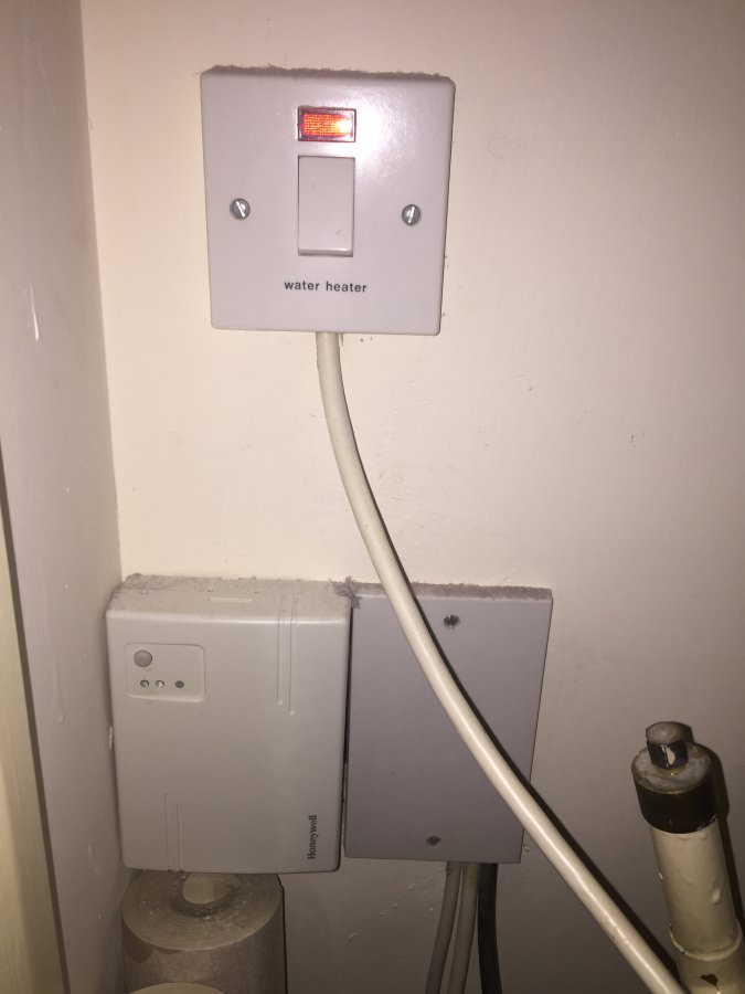

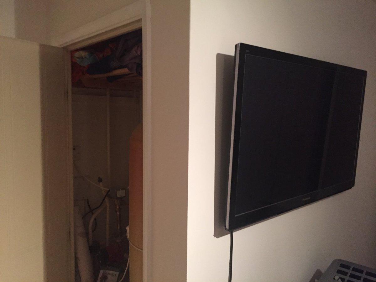

I have mounted my bedroom tv in its desired location but I don't have a socket anywhere near the location.
The only thing I have is behind the wall is the airing cupboard and things that control the hot water tank see picture.
Can I take from these at all?
You might be able to get under the floor and join into the socket circuit. Connecting in to the immersion circuit wouldn't be ideal for example in case someone in future connects a fan heater to that socket.
ALso, re that immersion heater circuit. Some of them only work at off-peak times does yours?
If it does then you'll only be able to watch your TV between midnight and 6:30 in the morning!
