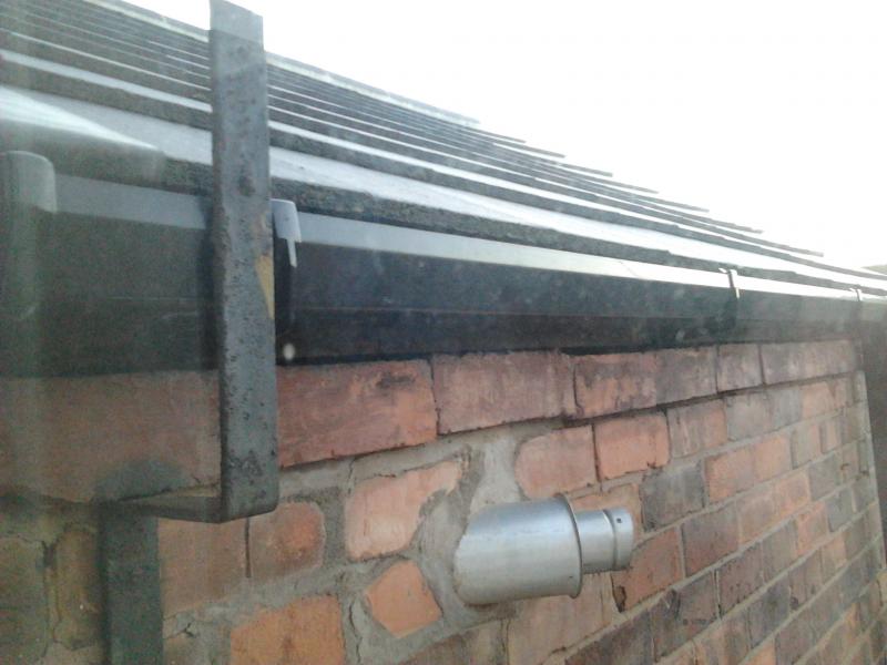

I would appreciate some advice concerning my new roof. The roofer has used a wood beam (is this called a wall plate?) to support the bottom of the roof and to this wood beam he attached the outside guttering. It is therefore partly exposed to the elements and I'm worried that it won't take long for this wood beam to become compromised or rot after a few years of exposure.
The roof tiles do not overhang this beam by very much and no facia has been used to protect the beam. I'm not sure if the beam has been treated either.
This is only the case on the back roof - the front roof has the guttering attached to a facia.
Is this usual practice?

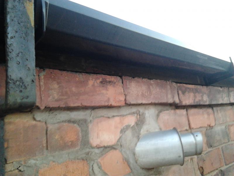

Thank you for your replies. Attached are two pictures of part of the wall plate (behind black guttering).
It's not an extension - when I bought the house the back roof needed to be completely replaced. This covered the main back roof and also the roof over the bathroom which is what I have shown in the above pictures (same applies for the main back roof).
Does this look alright? Should I look into getting some wood preserver and applying it?
Many thanks.
It doesn't look right so far,It needs a facia board to finish it off and keep the weather out,the gutter brakets are then mounted on the facia, that metal bracket looks very none standard what is it holding up? some more pics of the rest of the building would be useful to see what the detail is like on the original, some pics of the roof covering would be interesting and any pics of inside roof construction.

Fascia boards are purely decorative. I can't see any real problem with exposure, as long as the timber used was treated - that's properly factory treated, not given a lick of preservative.
Some properties were constructed like that, but it's not immediately clear if the roofer has done it by design or for expedience.
There may well be some issues with draughts and air leakage though, unless measures have been taken internally

if untreated then you can get insect attack,then moisture which if it doesnt disperse may lead to wet rot then continue into dry rot then you have problems,THIS IS WORST CASE SCENARIO :rolleyes: or it could be perfectly ok for the next 50 years ;) .like as you find in certain properties with timber that hasnt had any kind of covering at all.
treated none of the above for a long time. :LOL:
Thanks Gregers. So could I apply some wood preservative to avoid insect attack/moisture causing problems or won't this work?
There are plenty of properties with exposed spar feet but this roof has the wall plate on the outside??this will rot or cause ingress of water leading to other problems a facia board would give rain a run off, if the roofer has not allowed for this he's set it out wrong and I would say not worth a blast on a ragmans trumpet
I would not worry about it as it looks like rough sawn treated timber to me, but there is nothing to stop you unclipping the guttering and painting it with bitumen paint.
Yes but if the gutter spills out of the back of the gutter it can go under the wall plate and into the brickwork. A fascia board would prevent that.
