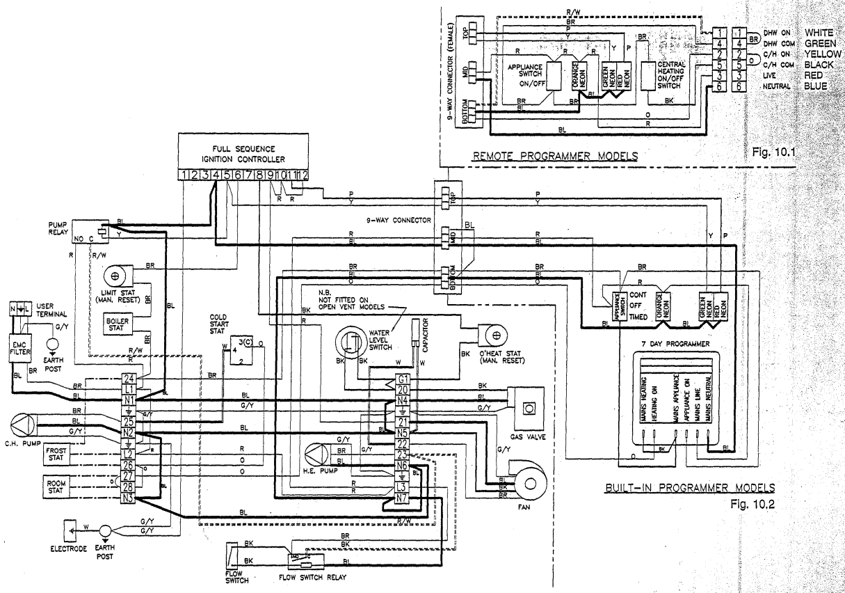

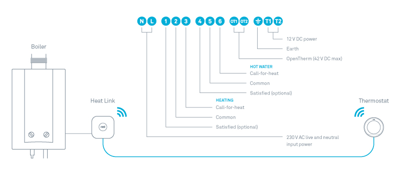

Apologies, another Nest example but I've not seen one for this boiler. We have a 13 year old powermax 185 (Yes, I know) that I'd like to control using Nest and Amazon Echo. I'm yet to purchase the Nest system but wanted to check my thoughts on the wiring before I go ahead.
I've attached the wiring diagram from the powermax installation guide and am planning to do the following, as per the annotations:
  1. Switch off at fused spur and remove fuse.
  2. Disconnect the existing thermostat wiring and use this as the 12v feed from the heat link to the Nest stat.
  3. Bridge the existing stat live and return at the boiler so the Nest stat is used instead.

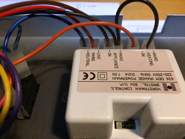

  4. Cut the cables to the existing programmer and insert a terminal block mapping the wires to the corresponding heatlink connections.
From the diagram (powermax - Nest)
R - Live
BK - 2 and 5
BL - Neutral
O - 3 (CFH Heating)
BR - 6 (CFH Water)
T1,T2 - 12v to nest Stat
I just wanted to check the difference in wiring BK to 2 and 5 separately rather than looping R to Live, 2 and 5 (as seen in other installs). I'm thinking the former will still allow the Appliance Switch to be used to switch off the boiler, not that that is important as its been on timed for the last 13 years.
Any confirmation/pointers would be gratefully received.

Well I went ahead despite not getting any feedback from the forums and everything is working fine. I did exactly what is described in my first post, cutting the cables as they leave the powermax programmer and connecting instead to the nest heatlink.

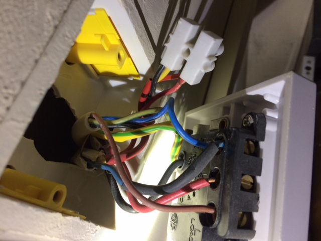

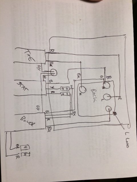

The wiring in the spur itself was a bit tricky as it's where the thermostat, main power and boiler power cable all meet. I've included a photo of this and of a diagram I drew so that I can put it back if I ever need to do so.

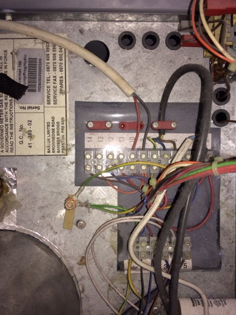

The next pic is the main connections in the boiler as shown on the diagram in my first post. This is before I connected a bridging wire across 9 and 10 and removed the stat connection.

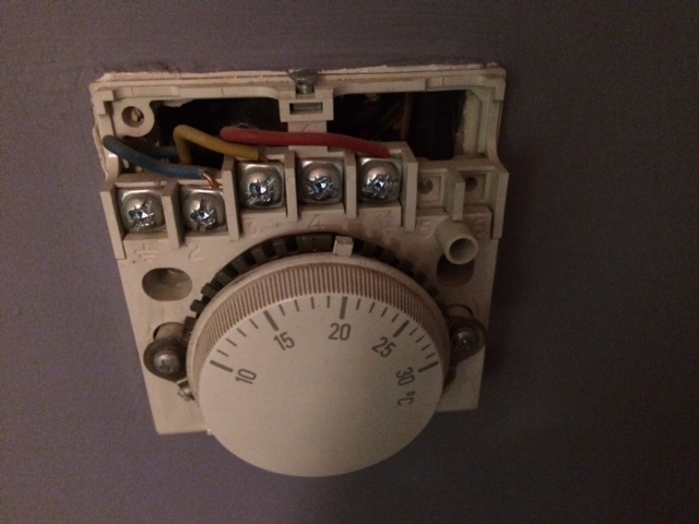

Finally a pic of the stat before I made any changes:
As I said, it's all working fine and we can now control the heating from any of the mobile phones but also by asking Alexa to "turn up/down the house temperature" or "set the house temperature to x degrees".
