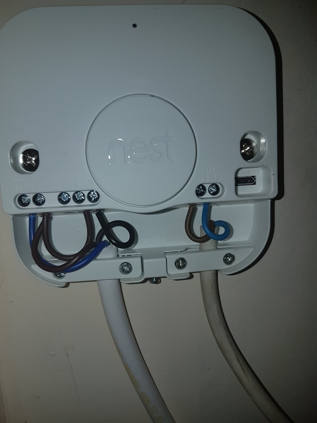

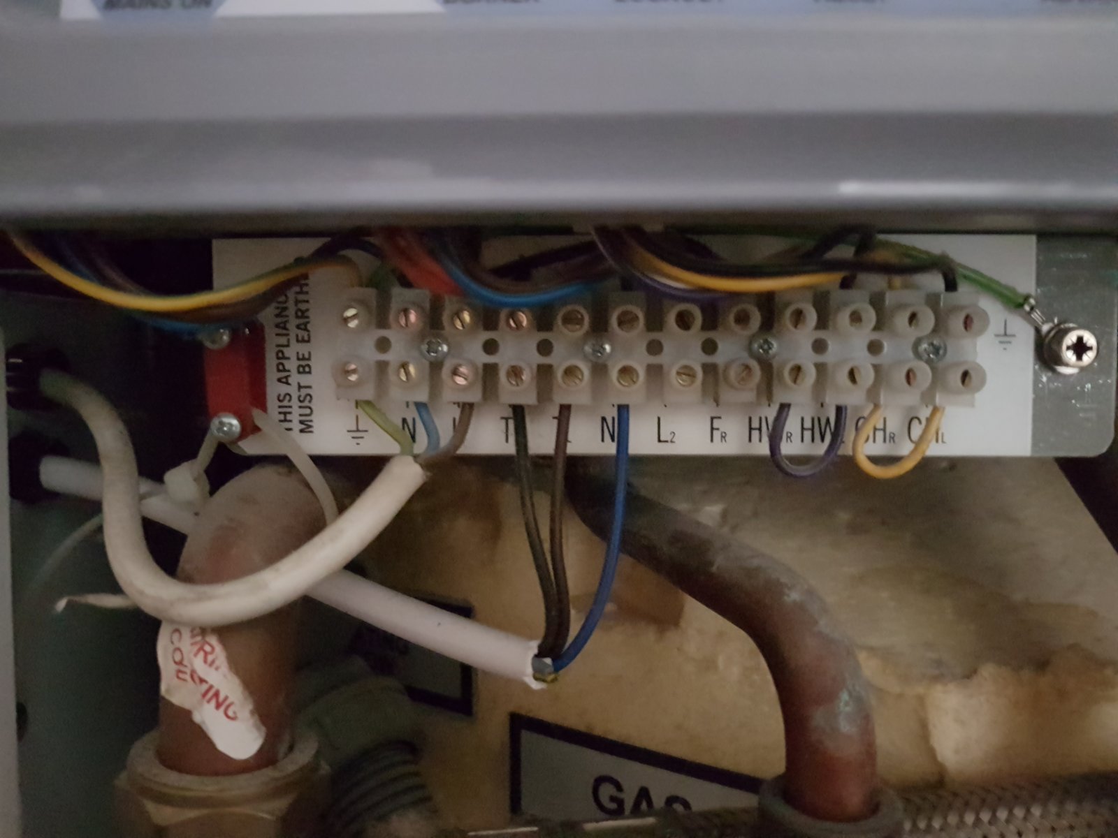

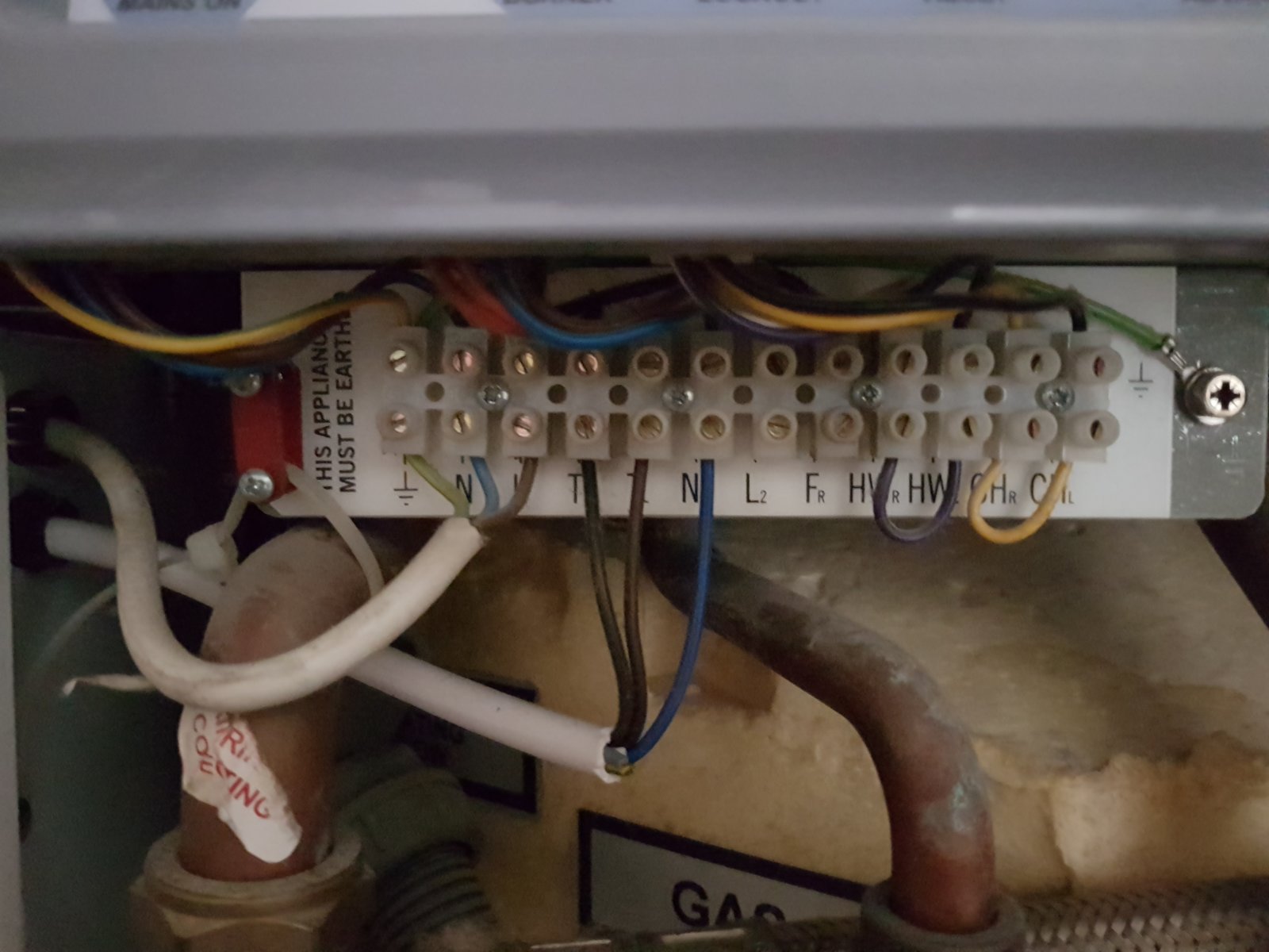

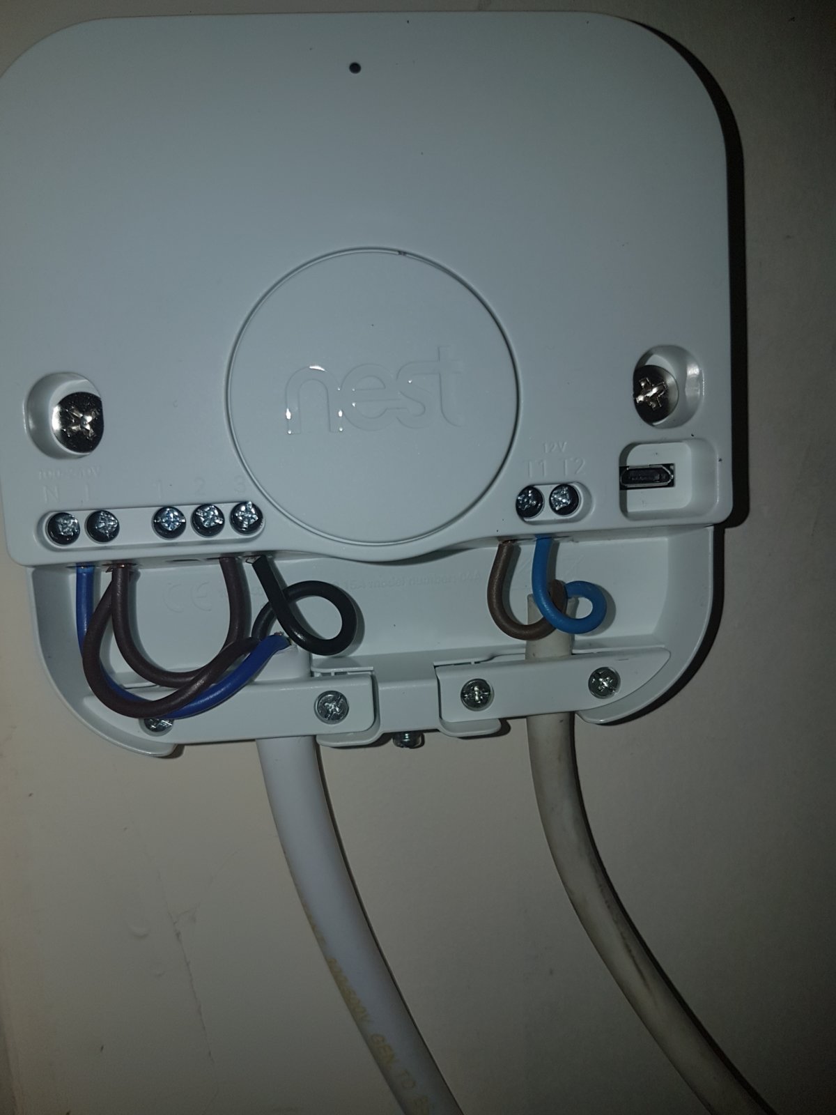

Hi Jamie. I have a potterton powermax he with Nest 2 connected to it. I have bought the gen 3 nest and tried to connect it to the boiler. In the previous set up I had wire from link box in N, L which was looped to 2 and another into 3 which is connected to N, TL & TR respectively on my boiler. HWR and HWL are looped and so is CHR & CHL (pictures are posted).However i wasn't sure regarding connection to control hot water with the new nest. Are you able to post a picture of your nest link box and the connection to boiler please. Thanks.

The photo you have posted is for the Nest Heat Link with Central Heating Control only.
To have control of a Hot Water function you need the Heat Link with the facility for it. It has additional terminals 4, 5 and 6 provided for this purpose.
Hi stem. Thanks for the reply. That photo of the heat link is with nest 2. i have bought nest 3 which has the terminals 4, 5, and 6 and wanted some advice regarding connections.
Ah OK. In that case, remove the brown link between HWl (Hot Water Live) and HWr (Hot Water Return) at the boiler, then connect them to the Heat Link as follows:
HWl = Nest terminal 5 - (Hot water common)
HWr = Nest terminal 6 - (Hot water call for heat)
That's all you need to do, no other link required at the Heat Link

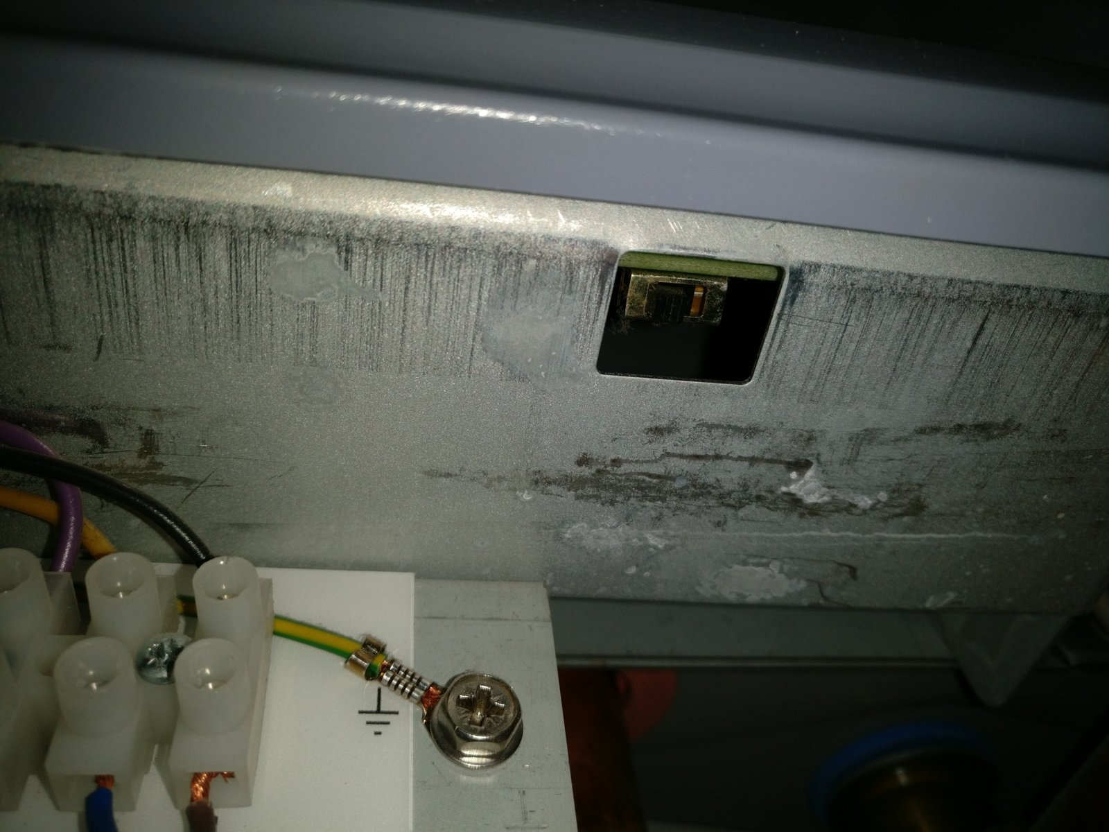

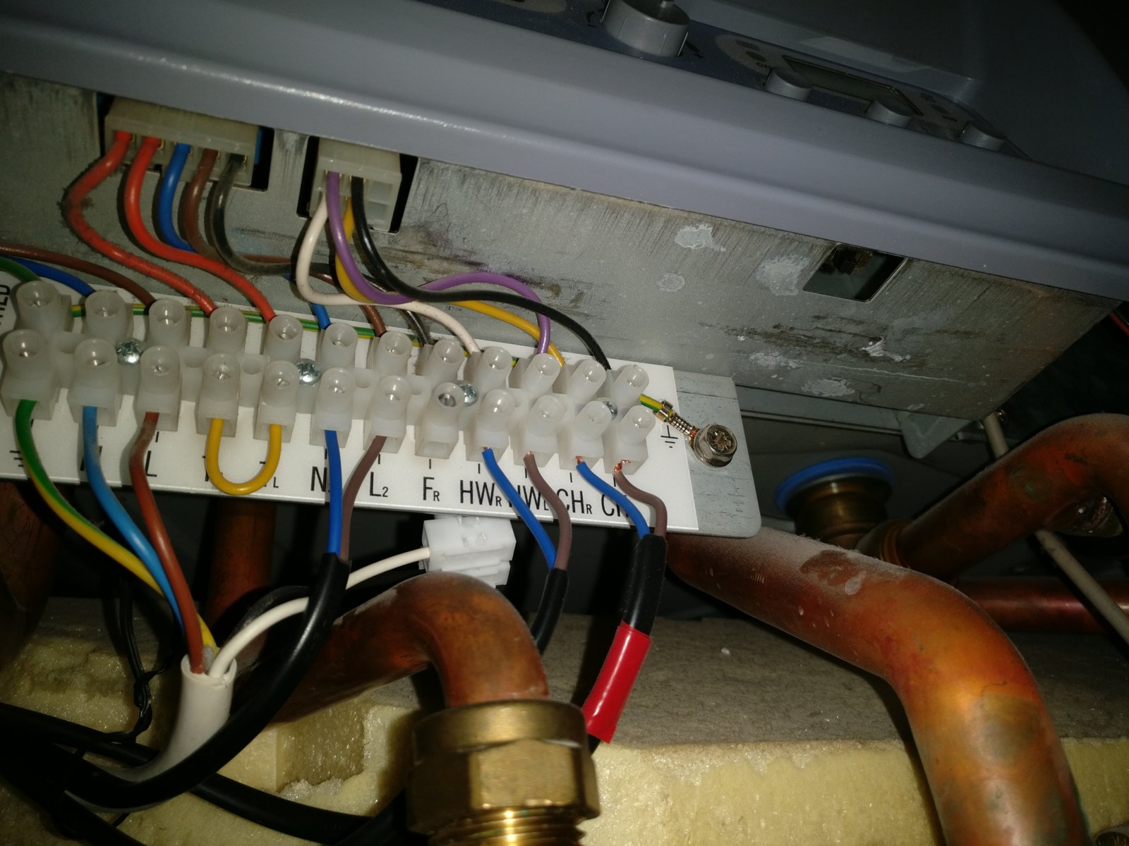

Hi Stem. I have installed nest 3 and connected as suggested. Central heating is definitely working. I do get hot water but I'm not sure if nest is controlling it. How can i test it. Do i need to switch off the internal programmer using the S9 button? Thanks. Jamie - any possibility of a photo of your setting?
The switch has to be to the left (as you look at it) to hand control off to the nest, and the on-board timer set to off. Couple of pictures included below
In terms of telling whether it's working... If your shower gets cold in a couple of days, it's not! I found (when mine wasn't working as one of the wires had slipped in the terminal) that the hot water tank kept the water hot for 2-3 days all by itself!
