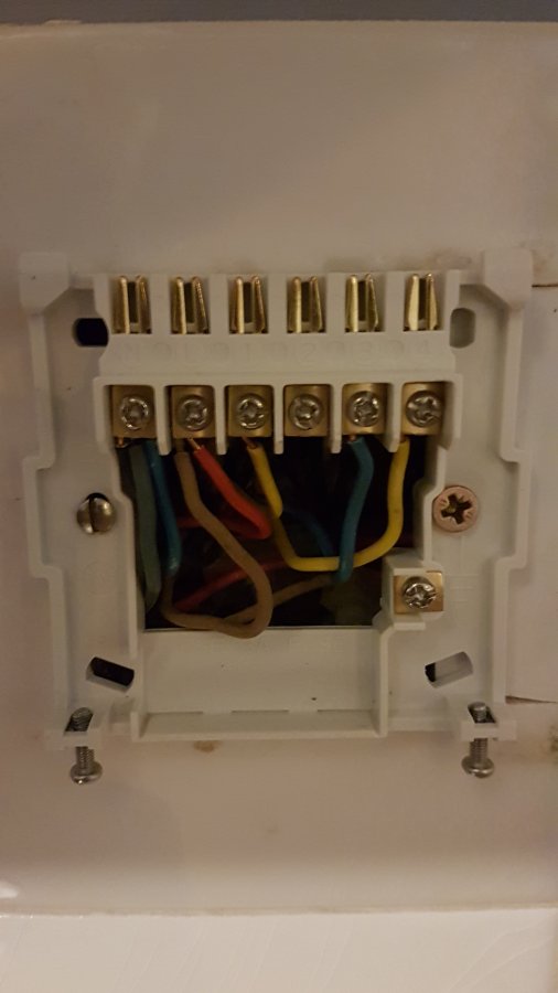

Hi Stem,
It's one 3 port valve (Y). I'll have a look at the wiring when home. I'll take a picture too.
Thanks,
Gordy
Photo's of the wiring often don't help unfortunately. They just show wires of varying colours which would have been chosen according to the original installers personal preference connected to terminals. It's what each of them is connected to at the other end that is important.

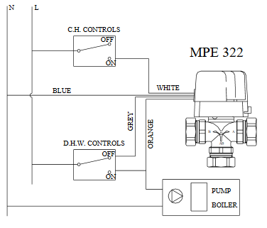

Something else to check is the 'hot water not required' wire this should be connected to the Hive terminal 1 (hot water off) is there a wire present on this terminal? If so where does it go?
I'm interested in the indicator lights on the valve, what model valve do you have?
Stem, common and satisfied wires swapped at cly stat?
when ch and hw on valve moves to correct mid position as room stat powers white, boiler doesn't start as no power from cly stat, when ch and hw are set to off the hw off signal sends power directly to the boiler, the valve moves to ch only as it gets the hw off signal direct from the programmer, though it would only go to ch only with both off if the hw was switched off before the heating. If the ch was switched off first the boiler would still run but this time the valve would be in hw only mode. If that isn't the case it would seem as you said there are 2 (or more!) faults.
Stem - Correct, the cylinder thermostat was a straight swap of the wires. This fault happened suddenly around a month ago, before Hive was installed, the system worked perfectly up until this point - I walked in one day and the house was melting, the boiler had kept running all day when the programmer was set to off. I'l' check the wire on terminal 1 and trace it out, will get back to you.
Echo - the valve is a Myson MPE322 link

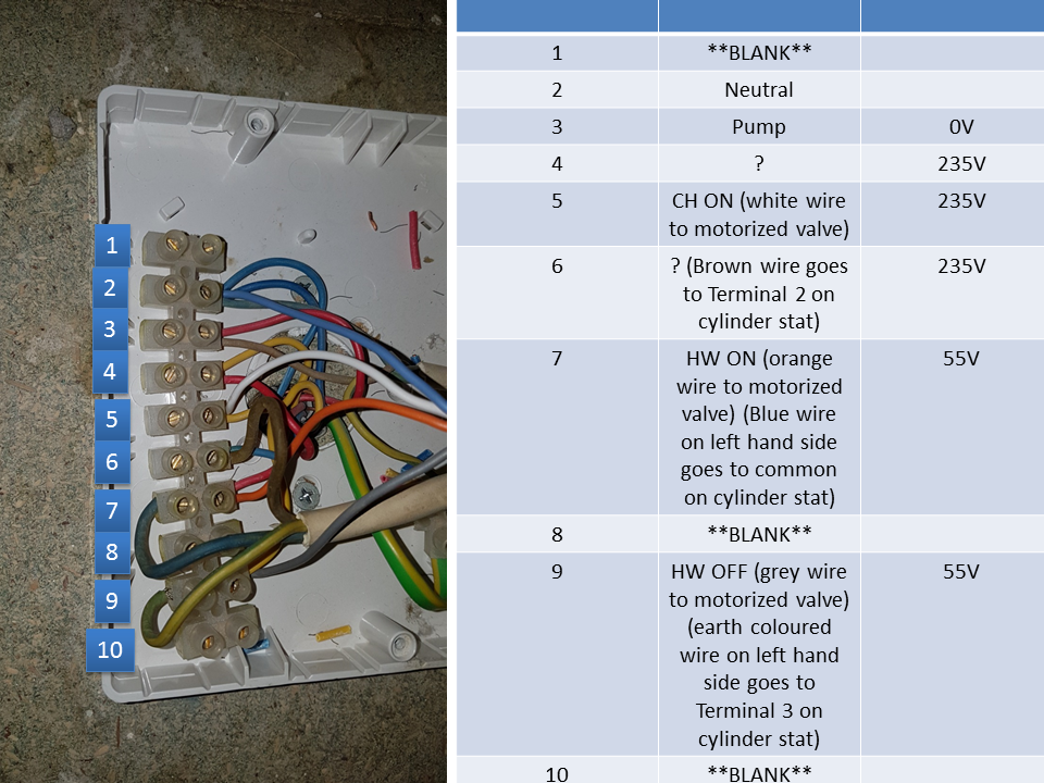

Just been up looking at the wiring again and realised I have a made an error - discount the second symptom I gave you for now, I was checking the wrong wire. When the fault state reproduces again I will re-check the voltages.
I had correctly checked the CH circuit (white wire) but not the HW circuit - I had checked the grey wire instead of orange, the grey wire was giving me ~55v. Sorry for the confusion.

Cylinder stat install says:
Terminal 1 = Common contact
Terminal 2 = (N.C.) CLOSED when the water temperature is below the selected set point.
Terminal 3 = (N.O.) OPEN when the water temperature is below the selected set point.
There is a wire on Hive terminal one (yellow), which I presume is the wire going to position 9 on the block connector.
I was close! Swap Brown and blue wires in the cylinder stat.
Terminal 4 in your wiring centre is heating on from programmer to the room stat.
Yep, that was my thinking. Com (1) and Call (2) are transposed.
It should be:
1 Common = Brown
2 Call = Blue
3 Satisfied = Yellow
And you can take the Hive out of gravity mode you don't need it, and are restricting your available functions.
