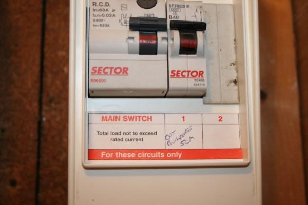

HI I have taken a photo of the supply in the house before it goes outside
it's the smaller trip on the right that trips.
it's difficult to trace as I reset and can switch the light on in the stable and it trips and also reset and switch the light on in the garage and it trips.

It's an MCB then.
So the MCB stays on until you put a load on the lights or a load on the sockets. Are both of these circuits individually protected at the distribution board in garage?
Are you absolutely sure its the small device on the right thats tripping?
If it were the RCD (larger on the left) that was tripping then it sounds like a classic neutral earth fault
if its deffinatly the device you say, then I'd be quite supprised, and the advice below probably isn't that usful to you

Adam, you are right it's the bigger one on the left that trips.
