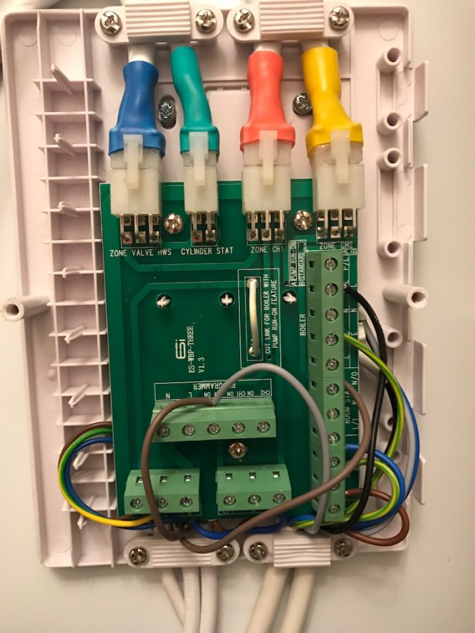

Hi there,
We recently moved into a new build house with a Logic Heat system boiler and I've just been reading through the various manuals for it to familiarise myself with these things and have noticed something that says that the central heating pump must be connected directly to the boiler or it will void any warranty.
I assume this is so the boiler can control an overrun after it has been heating.
However, on investigating of the wiring centre in our cylinder cupboard (where the pump/valves are too) the pump is connected through a PCB and only switched on when the boiler is on and immediately stopped when the valves close. I've attached a picture just in case it's useful. The pump is connected to the bottom left connectors and the boiler is the top right under the yellow plug.
I rather need to know whether I need to raise this with the building company or not. Is it problem for the boiler not to be able to overrun the pump? Will it do any lasting damage?
Any thoughts would be very welcome :)
Many thanks in advance.
Adam

That boiler uses the integral fan to cool the heat engine in the boiler, so no pump-over run required.

It's on page 9 in the document below but I've just seen the URL while posting it here and it's an old version of the manual. I've now found a newer version of this document (which relates to my actual boiler) doesn't show the pump as being connected directly to the boiler so as PullerGas mentioned, it is not required.
http://idealboilers.com/wp-content/uploads/sites/2/2014/01/Logic-Heat-Installation-Manual.pdf
