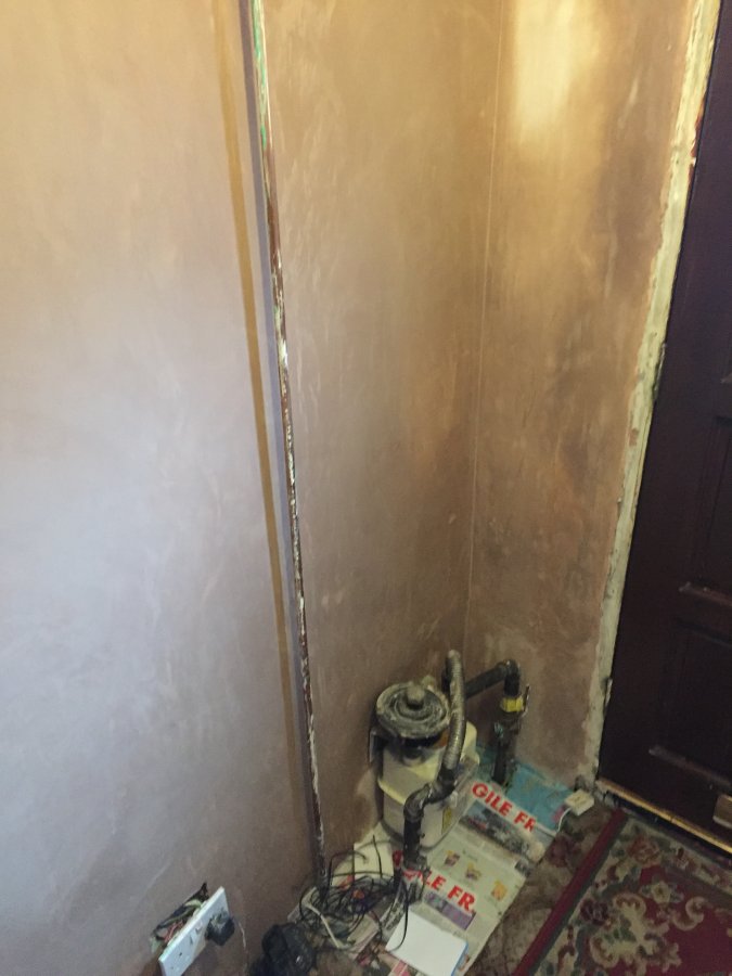

I'm looking at options of moving a 15mm pipe location which runs hot water from the first floor to ground floor (sink).
I don't have any experience using solder apart from circuits boards and wanted to understand peoples experiences and recommendations of the choice of joints.
I understand the pressure of the pipe can sway the decision of the joint, however, in this situation its a normal domestic setup with a combi boiler and one bathroom.
I do live in a semi hard water area therefore not sure if this affects the seals of a pushfit. Has anybody had any experience of push fit (JW) leaking in normal operation?
Any thoughts welcomed.

I have heard push-fits fail over time as hard water scale can build up around the seal over time causing a leak, any thoughts?

I've not had that issue. Will the fittings be accessible once you are finished?
One fitting will be under the bath which can be access be removing the side panel. The other fitting will be behind the gas meter (picture attached). I would like to move the pipe in the corner of the wall.
I'm concerned of the fitting leaking and then ruining the new fresh plaster on the ceiling.
