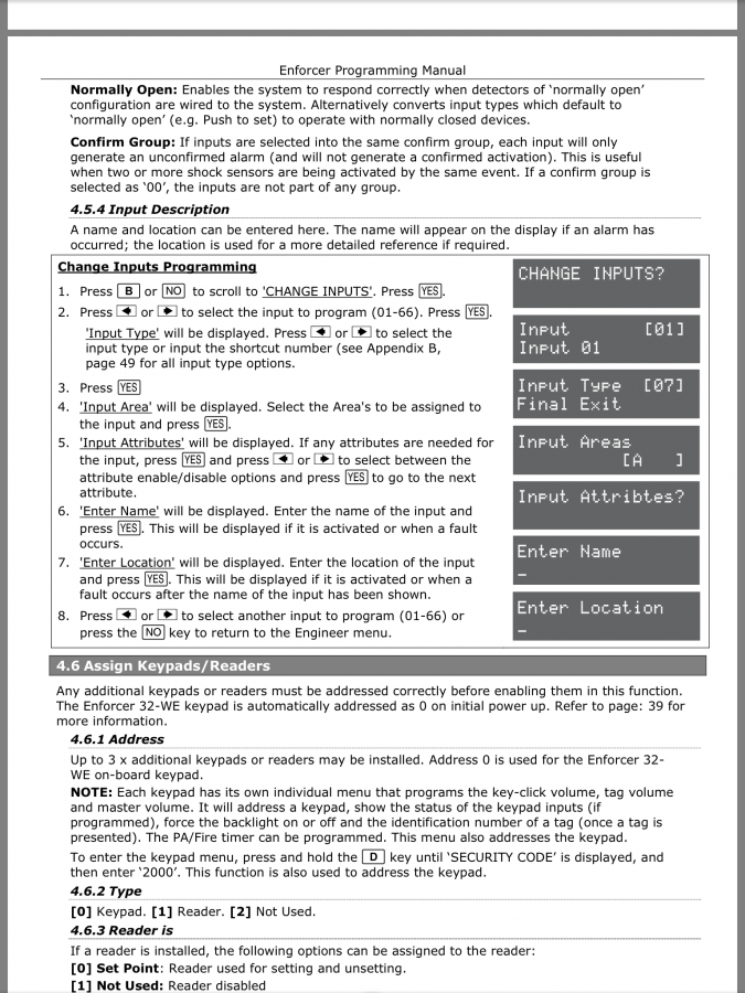

Could anyone please explain how to programme door contacts to chime. The panel displays c but I still have no chime.
Thanks!
Zone needs to be enabled for chime ... Zone attributes ...chime ....single from engineer programming
Thanks sparkymark. Is this quite self explanatory once in engineering mode?
Go into engineering
Change inputs,press yes
Go to zone number that requires chime
Go to input attributes
Select chime single
Come out of engineering
Remember to save changers
Press C on keypad
Should now have C in display
Open door should chime
View attachment 111509 Go into engineering
Select chime single
Press C on keypad
