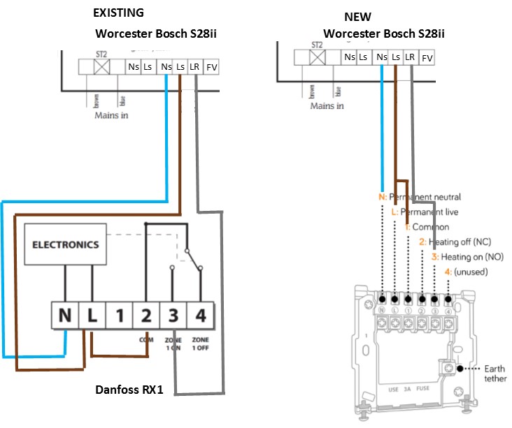

Just a quick check to make sure I've got this right - I've currently got a programmable wireless roomstat Danfoss RX1 and am swapping it for a Hive 2. No programmer on the boiler - all done from thermostat.
Intended wiring below - does this seem correct?
Yea that will work although id personaly use the mains L+N for the hive rather than how the dnafoss is wired but thats just me being picky.
Cheers - picky is good!
That would leave Ls going to Common on the Hive and and N & L on the Hive being fed from the Mains In N & L on the boiler?
