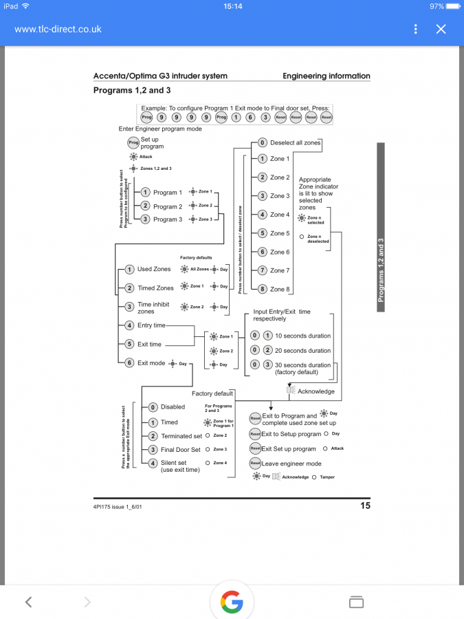

afternoon all.. I'm at the end of my tether..I have a ADE Accenta G4 alarm been trying to reduce the exit time from 30 sec to 10 sec I have no manual so been online and got the manual but cannot find how to do it any help would great
cheers
Enter9999 prog1501reset reset reset reset that should make exit10 seconds
