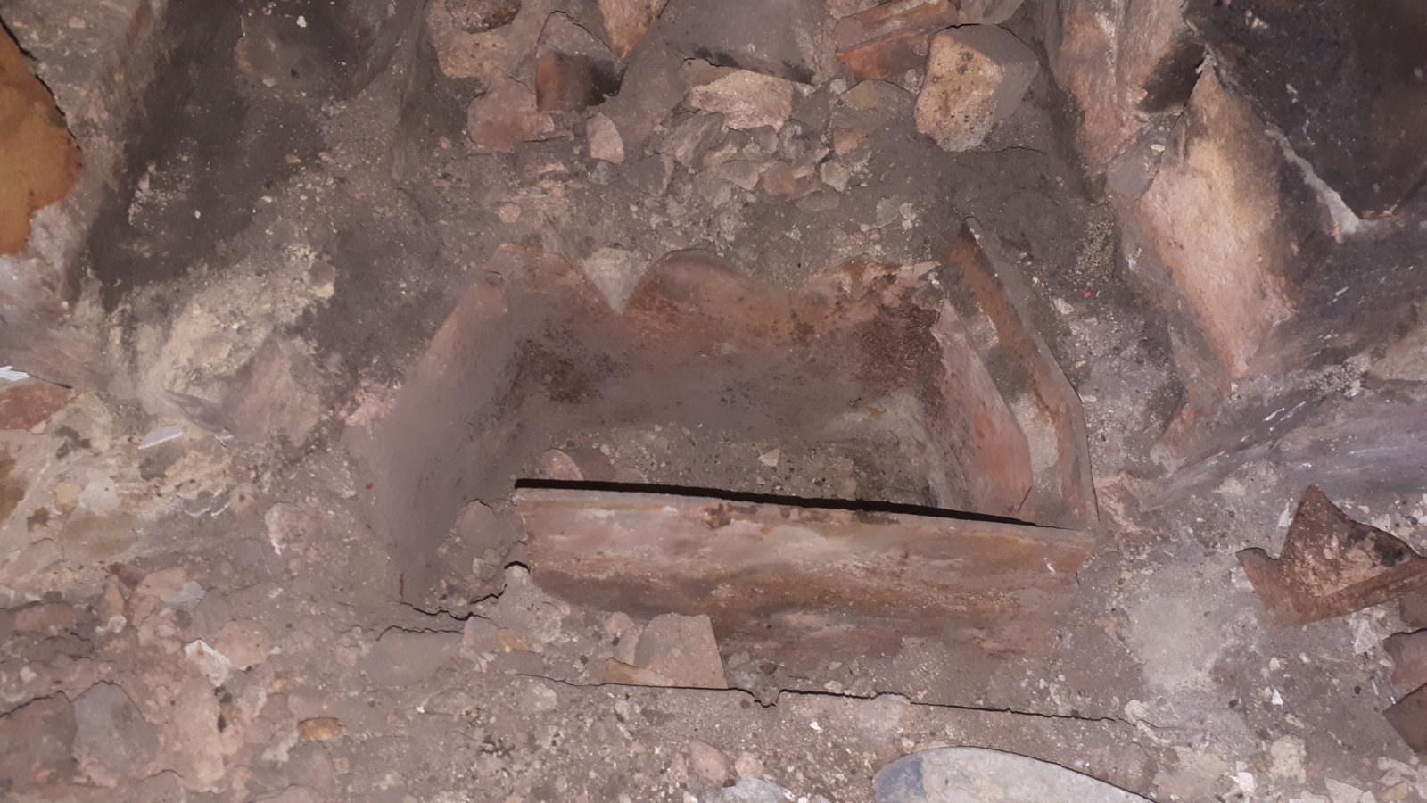

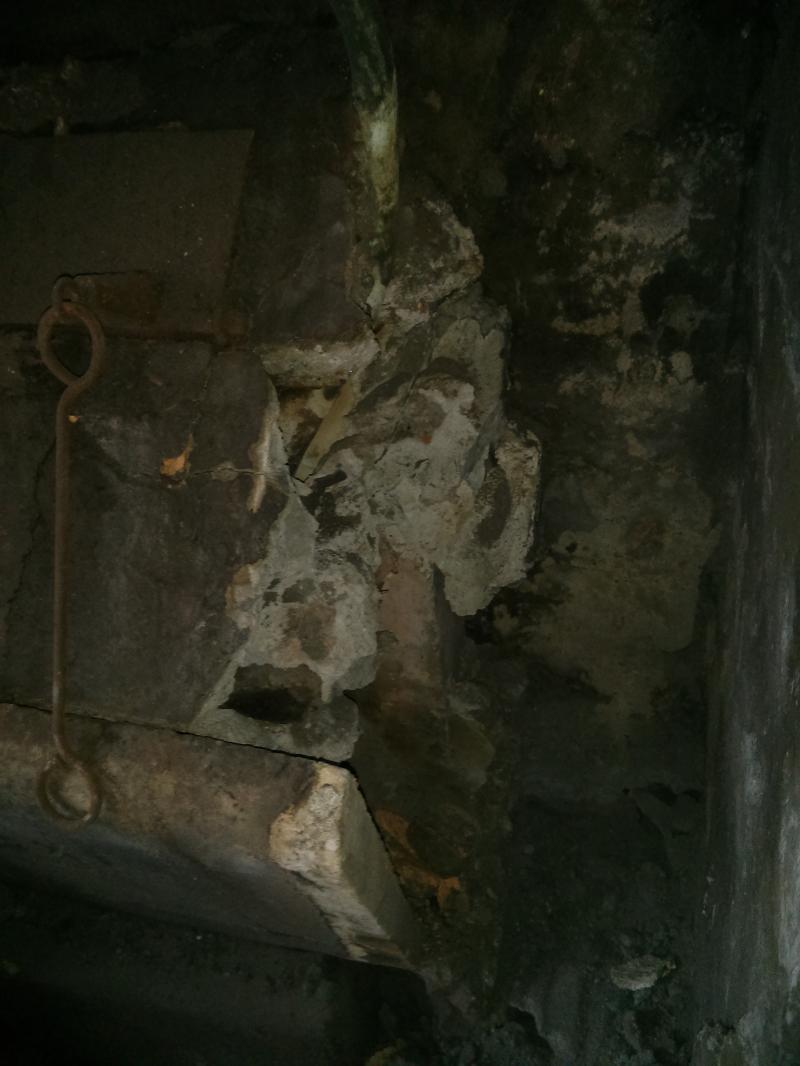

I'm currently stripping out a 1930's semi detached in Liverpool. After taking out the old gas fire places I've un-covered an old (possibly original) Baxi back boiler.
Today I removed the bricks around the boiler which came out easily with an SDS drill, I then noticed the casing the Baxi had a crack in it, so took my drill to it and it's coming apart very nicely. However I suddenly realized some of the casing (which I presumed to be cast) was actually white in colour. I downed tools and went to search on the internet to see if there's any records of old Baxi Back Boilers containing Asbestos. I couldn't find anything but just wanted to check here first, what do you make of these photos?
Probably lime morter as it gives insulation and thermal movement properties so brickwork doesn't crack.
The list I have on The Manuals Library doesn't contain any Baxi back boilers (GC 44 xxx xx) as containing asbestos.
When I compiled our list it became painfully obvious that there is no definitive, guaranteed complete, list of any equipment, let alone boilers, that contain asbestos. Nor do available lists claim to be complete in listing the areas where asbestos containing components are located.
We carry a warning simply advising that if anything looks as if it might contain asbestos treat it as if it is asbestos. One will then always err on the side of safety.

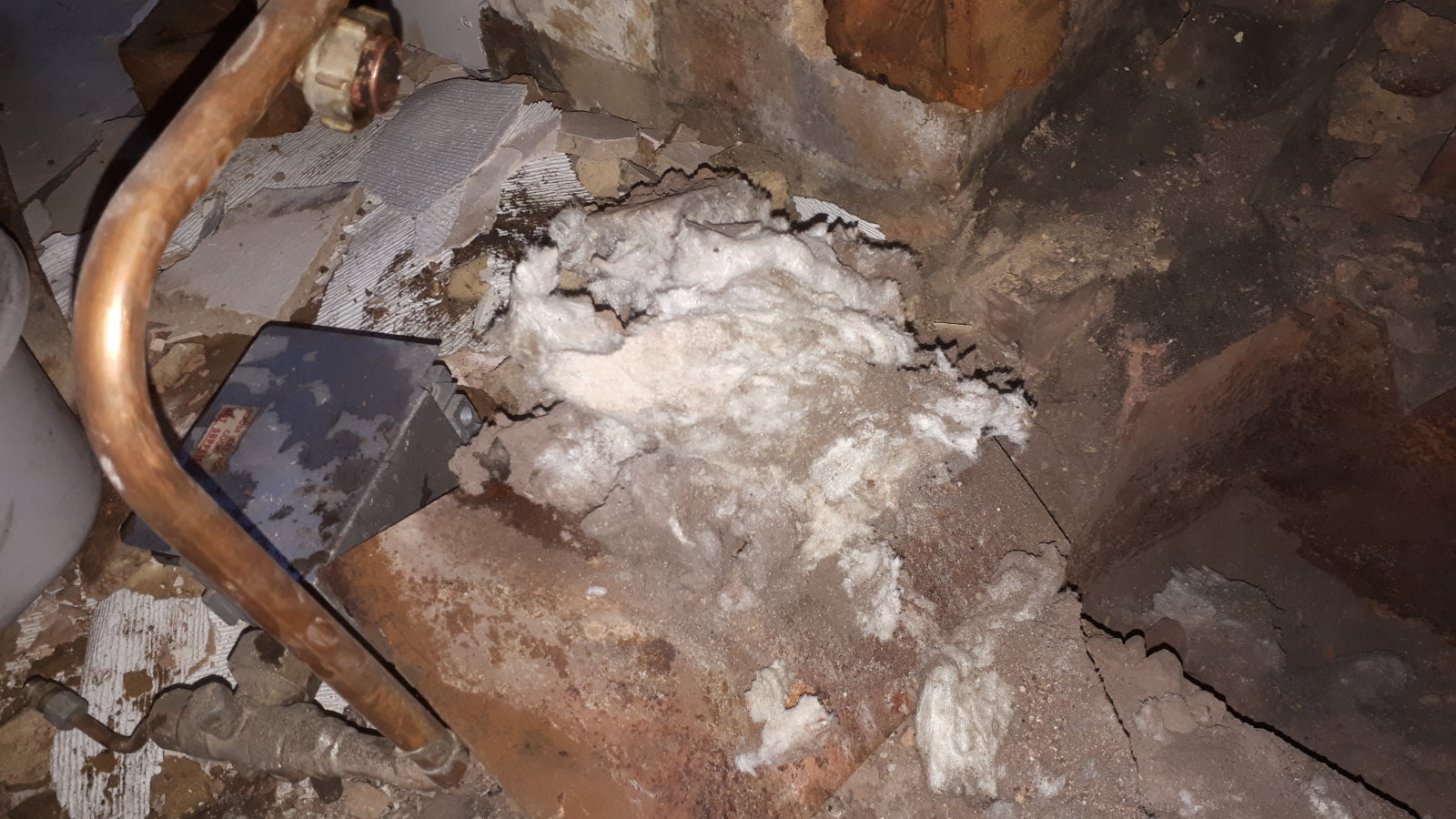

I'm removing a 1980s back boiler, but the remnants of some earlier fire are there.
Undernearh the boiler was the old cast iron ash box as per your photos. Mine is for underfloor draught
The box is encased in what looks like white glass wool insulation. Not sure if this is asbestos based or not?
