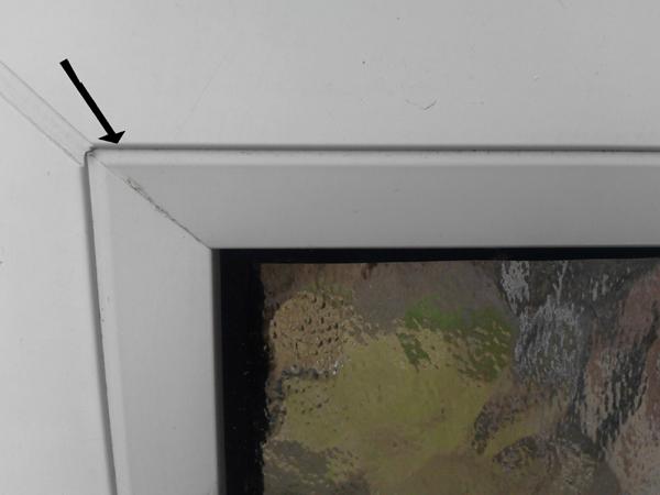

Hi Could someone let me know if I'm trying to remove the beading on this door in the right place. I've marked where I am trying to get the blade into, but it's extremely tightly fitted, and I'm getting nowhere.
Do I need to use a fair amount of wellie?
Hi, thanks. So do I need to be pushing the blade into the side where I have arrowed (but in the middle) or the part of the bead next to the glass?
Any do I really need to force it in there? I'm worried about breaking something.
Many thanks.
Start in the centre of the longest bead the same side as you are attempting.
give it a chap and the bead should pop out, the rest should come away easier.
Yeah just get it in there and push the bead downwards (in the direction of the arrow) Don't get the bead out as if you were trying to prise off a paint lid (if that makes sense)
