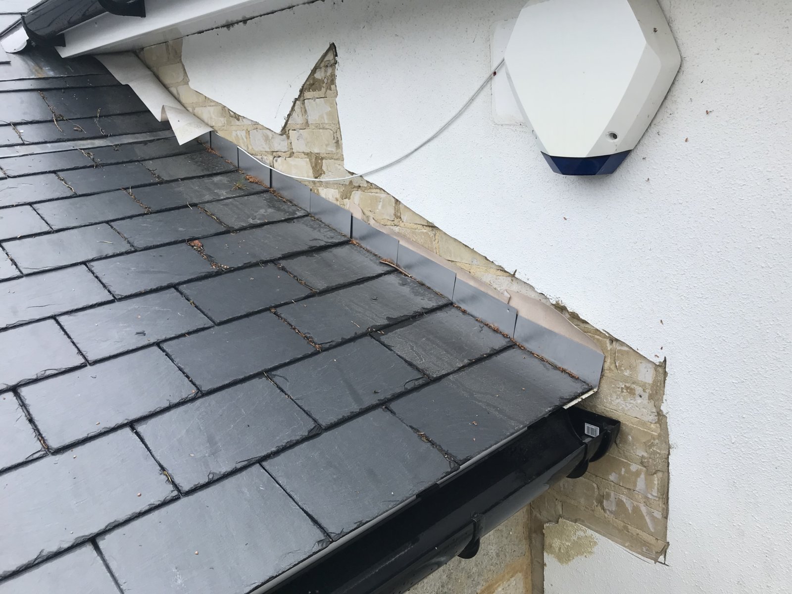

Hi,
I know this is an old thread but I have a similar problem and an extra question.
My abutment wall looks like this:
I intend to put lead over the soakers and chase it into the wall then a bell bead over the top and render to that.
How do I chase the lead in? The bricks are pretty soft so could I just grind out a straight line?
Or, should I do stepped chasing into the mortar around each brick?
Thanks.
